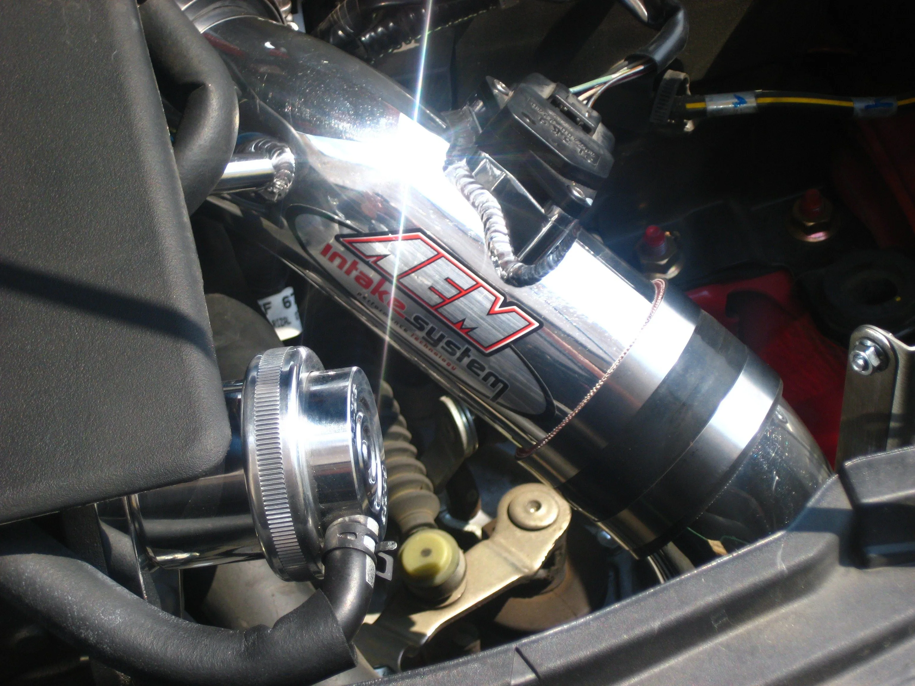

Got and AEM CAI and Forge (Import Image Online bundle @ $400) installed last weekend... HUGE difference.Boost starts as low as 2400rpm and builds very strong/smooth.* Even though the Forge is a BPV and not true BOV due to recirc, it is plenty loud and sounds amazing - the "whhooooossshhh" from blow-off is awesome and the whistle is an nice touch (I can't hear the "ping" everyone talks about though - blue spring with 2 shims).Being in Austin, rain does happen, but far enough between I'm not worried about the wet - worse case I'll tape over the vents in the splash-guard in the "winter" time and avoid water crossings.
