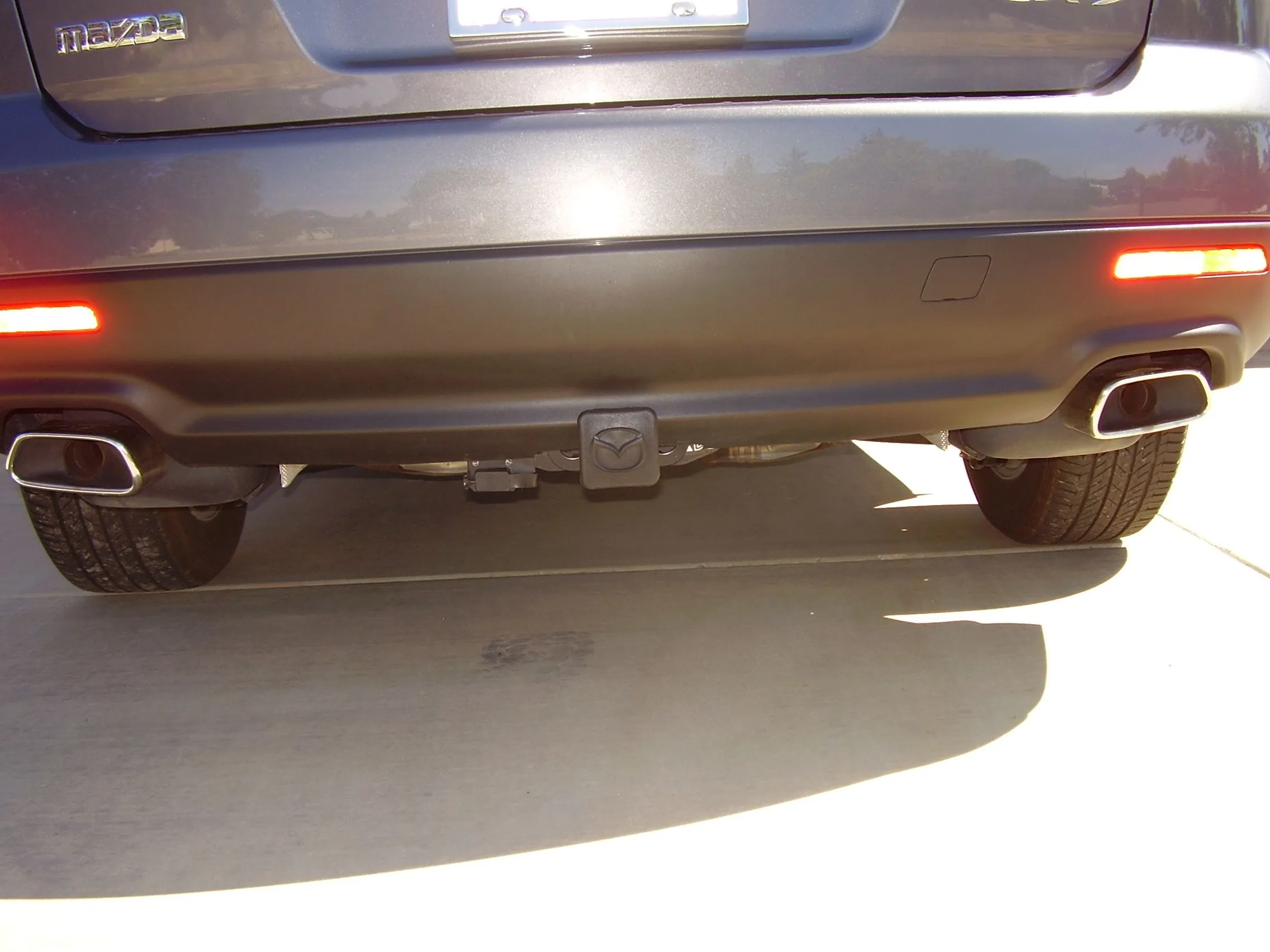

I prefer the factory receiver. so I put one on our Sport for accessories and wired up some basic lights just in case we need to tow a small trailer.
I just ordered a Curt hitch. I saw another CX-9 owner had one installed and it looked very nice. Very OEM looking for a 2". I saw the Hidden Hitch was a little cheaper, about $20, but have not seen one installed. Such a limited amount of CX-9's on the road I get cautious without first seeing it installed. I don't know if it is just my area, but the Mazda's still are very unpopular in comparison to the Acadia. I rarely see another Mazda.
Maybe the only Sport with a factory hitch....

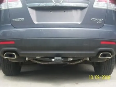

I Installed the Hidden Hitch. They don't offer the OEM here in the Mazda Dealer in Costa Rica, because most of the mounts here are 2". You do not have to cut the bumper, it looks tough and it is easy to install. Look at etrailer.com
