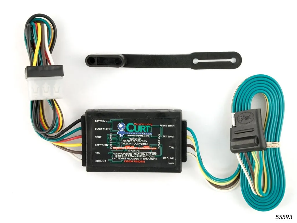

I have a 2010 mazda cx 9 , I am installing a hitch and the wiring. I have been looking for answers for the harness to purchase .I found the hookup in the back of my car, and tested each prong one is for left blinker one for rt. taillights,and brake lts.the other two which had a black and the other green wire to them had no reading ,i noticed in the fuse box in the glove compartment that there is a slot for trailer and takes a 15 amp fuse but did not have a fuse in it,the book says nothing, i put one in and got constant power from the one with green wire.does this need to b in and what harness should i purchase for it,any help would be appreciated.Thanks
Mazda's own harness is the best fit, without splicing any wire. See the first post for part number and pricing. Save yourself time on the guess work. The fuse is included when you buy the harness from Mazda. Otherwise, that slot should be empty.
Someone told me I can use the harness from the 2009cx 7 ,I tried to attach a picture ,I ordered this on eBay for$ 23.00 .I guess I'll try this if not Ill order the one above from Mazda
