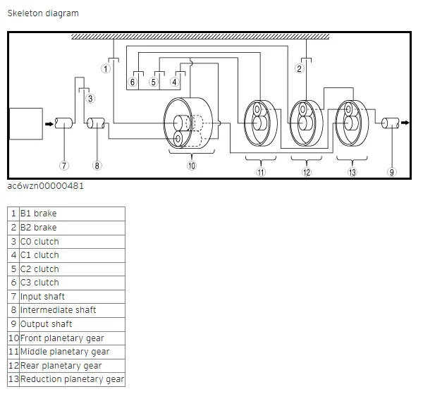

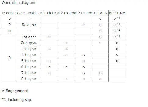

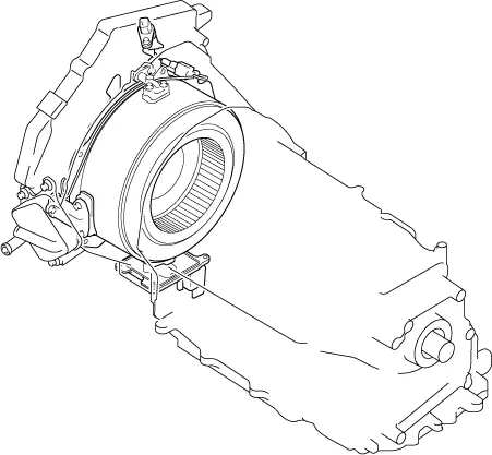

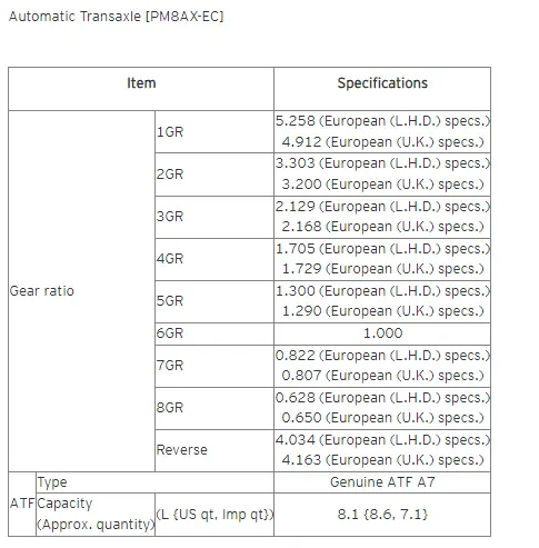

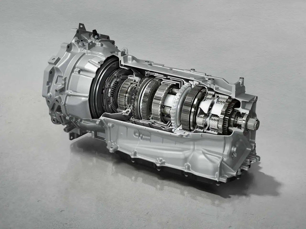

New transmission is called the PM8AX-EC. Info is starting to come out about form and function. Really cool implementation. There is no torque converter, some of the early literature listed it as a DCT(whether from mistranslation or not) style buts its not a conventional DCT either. Its a planetary gearbox with an electric motor in the front of the unit. There is a clutch on either side of the motor. The clutch on the engine side can decouple the engine for full electric driving. There are 6 Clutch sets inside the transmission(1 on the back of the motor 2 brakes, 3 driving) and 4 planetary gear sets. When it launches from a standing start it locks the B2 brake and the C1 clutch set, it slips the clutches in the B2 brake for reverse and forward to get moving, once moving it locks that clutch as well. It then behaves as a regular planetary transmission for all other gears. I'm very interested in driving it to see how that feels in practice.
