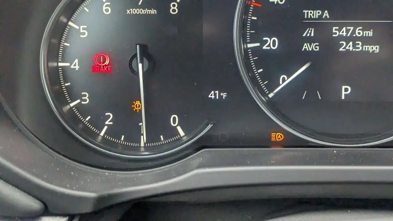

Get it back, and one of the other headlights started to get moisture in it. Wife drove it. Then came the AFS warning light on the dash. See image.
Took it back to body shop, they put in a new headlight. Cool so two new headlights.
Every time the car starts, the AFS light comes on. If you turn the light stalk to off, then back through all the settings to on it then goes off. However, the headlights dont turn when the wheel turns. Ok so maybe they put in a wrong headlight. Whatever.

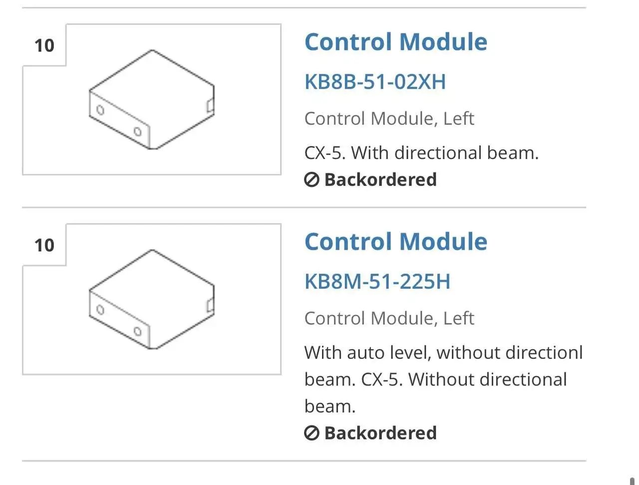

Are we sure if the control module is broken or it simply needs to be re-calibrated?
