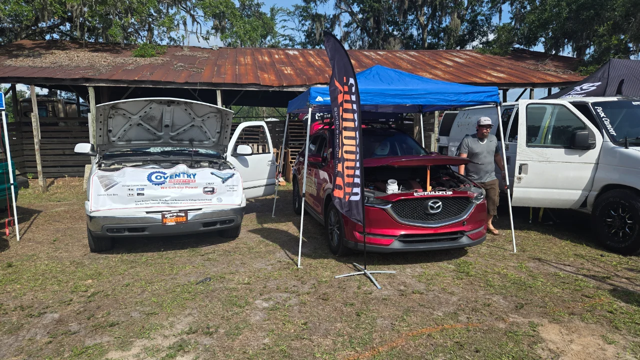

I've long since this post beat this charging systems butt lol. Send me a DM. I'm currently running a 250a alt at 15.7v with 87ah of SCIB LTO.
