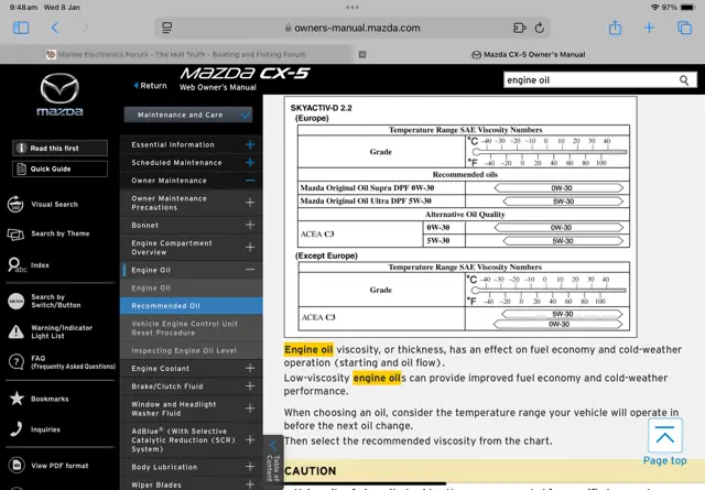

Here are some screenshots from the CX5 owners manual relevant to Euro spec Maxdas. And a link to the manual in case you dont have one.
Note that it specifies use of an oil meeting the C3 specifications.
C3 spec oils are LOW SAPS oils
C3 oils have a low sulfated ash (SA), phosphorus (P), and sulfur (S) content, or mid-SAPS level. This helps to reduce ash-forming content and protect exhaust aftertreatment systems.

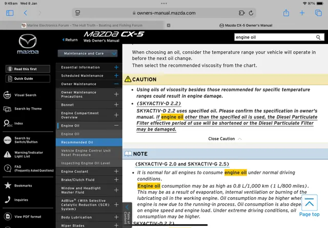

You will see that I also included a photo from the manual about the damage that Mazda themselves say that using a non C3 spec oil can cause to a dpf (diesel particulate filter). If you google the cost to replace a dpf, hang on to your wallet, its not pretty.

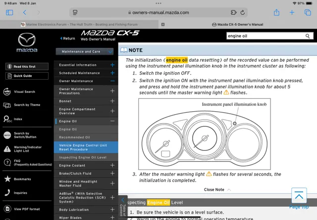

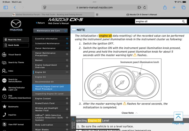

I also included a photo of the page from the manual detailing how to reset the oil data so the weench light goes away after an oil change,
