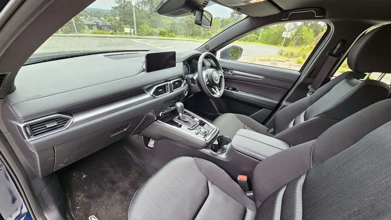

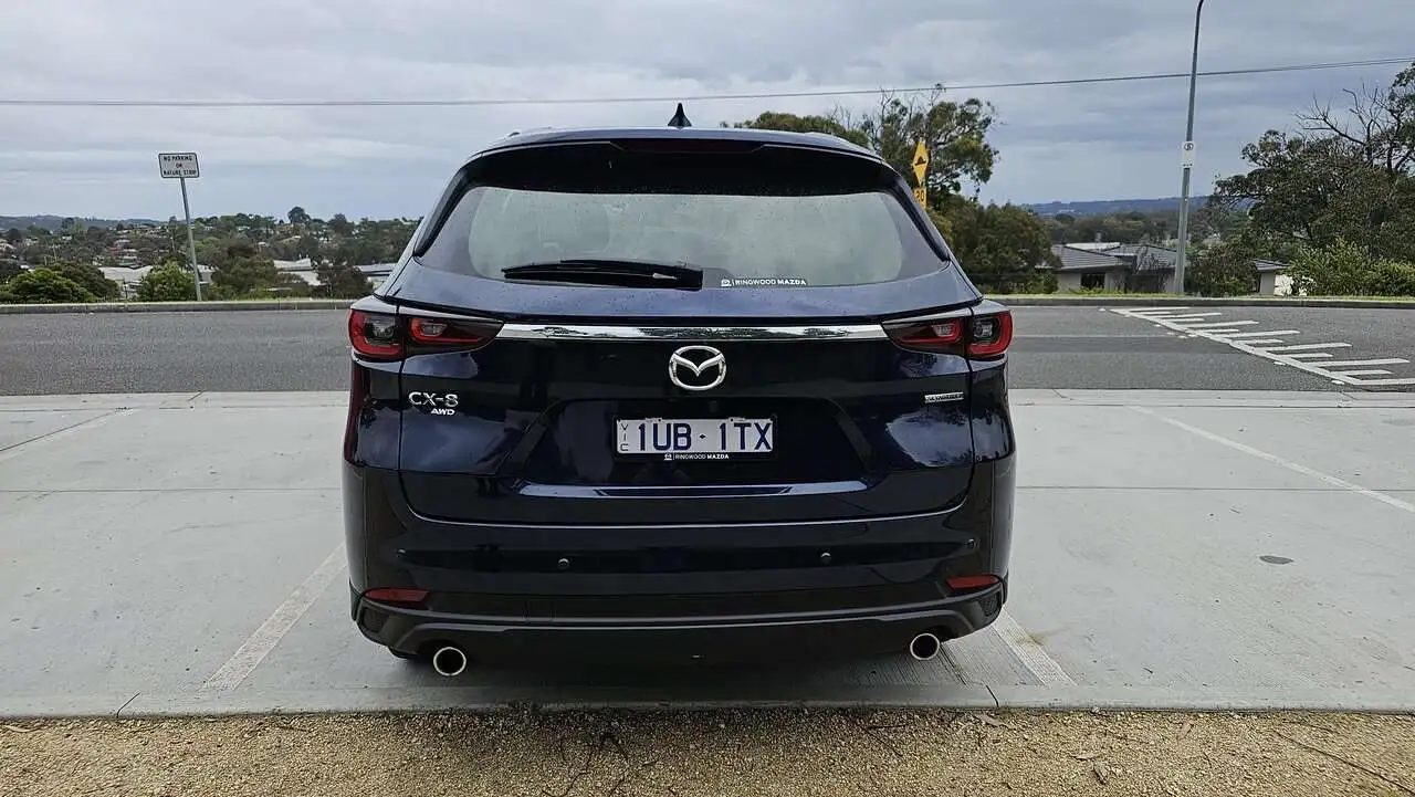

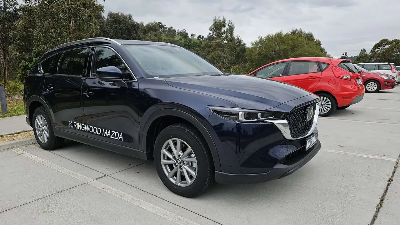

Side note regarding the CX-8...I believe it's still for sale in Japan and Australia...Not sure about other markets such as China, Thailand and Vietnam.
We certainly have the CX8 here in AU.

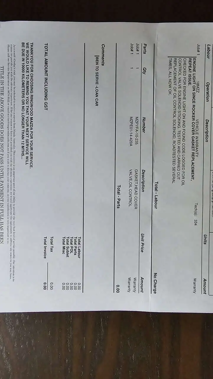

Update: The dealer replaced the OCV (Oil Control Valve) and said it may have been damaged while the valve cover gasket was replaced.
They kept the car for another day to drive it and see if the check engine light comes on again, it seems fine so far.
Will pick it up today and have a longer trip tomorrow. Again fingers crossed that's the end of the story.

The OCV itself is prone to leak on CX-5 but we’ve never seen it caused any CEL. It’s nice it got replaced for free ($$$) now, as most likely you may need it in the future.
It’s strange that your dealer refused to give you the CEL code. Usually it’ll also stated on the invoice at the time you visited. Without telling you the code we can only guess and pray.
