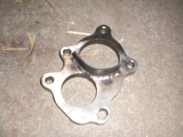

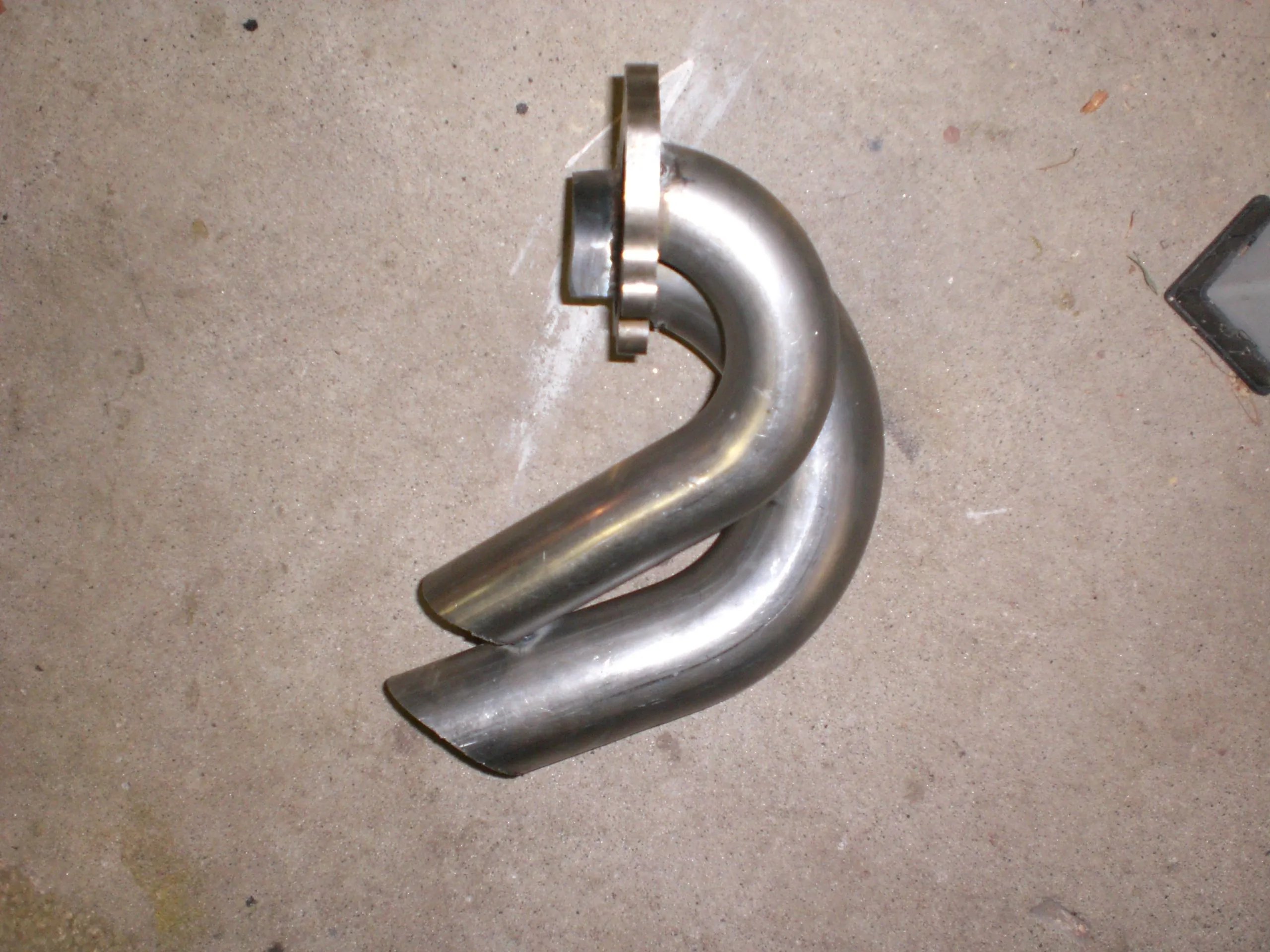

So i got bored and had some flanges and pipe laying around and thought i would make a down pipe. Instead of just making a full 3 inch, i used a divided flange for two different pipes. One for the exhaust and one for the wg, and then the both run into a 3 inch pipe. Ill post pictures when i get time and you guys can let me know what you think.

What i meant by that is i had a bunch of flanges that i made up at work for the turbo and turbo mani. And its not going to look the best, im just using mild 16 gau. steel right now, just to fit it all in the best possible way to get to the nuts and still have good exhaust flow. But the final product will be made out of stainless, and tig welded together. It hopefully will look somewhat like the GHL down pipe.

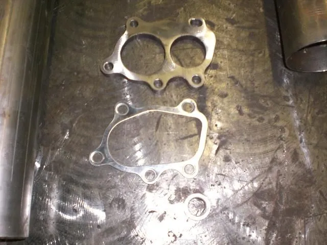

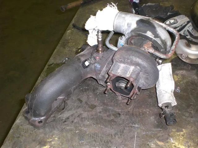

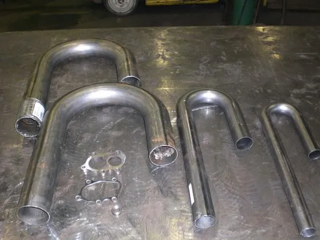

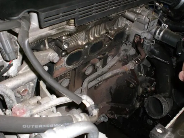

Ok so this is as far as i got for pictures so far. We do have the pipes cut and pretty much fitted, ill get pictures soon. We had to take the whole mani and turbo off so i could fit the divider on the flange. As you can kinda see the divider fits into the housing. Hopefully it will be done soon. I only have weekends to work on it and im going snowmobiling this weekend so it might be a little bit longer.

Hopefully soon ill have the finished prototype. Then ill build a jig, and actually make it out of stainless and tig weld it.

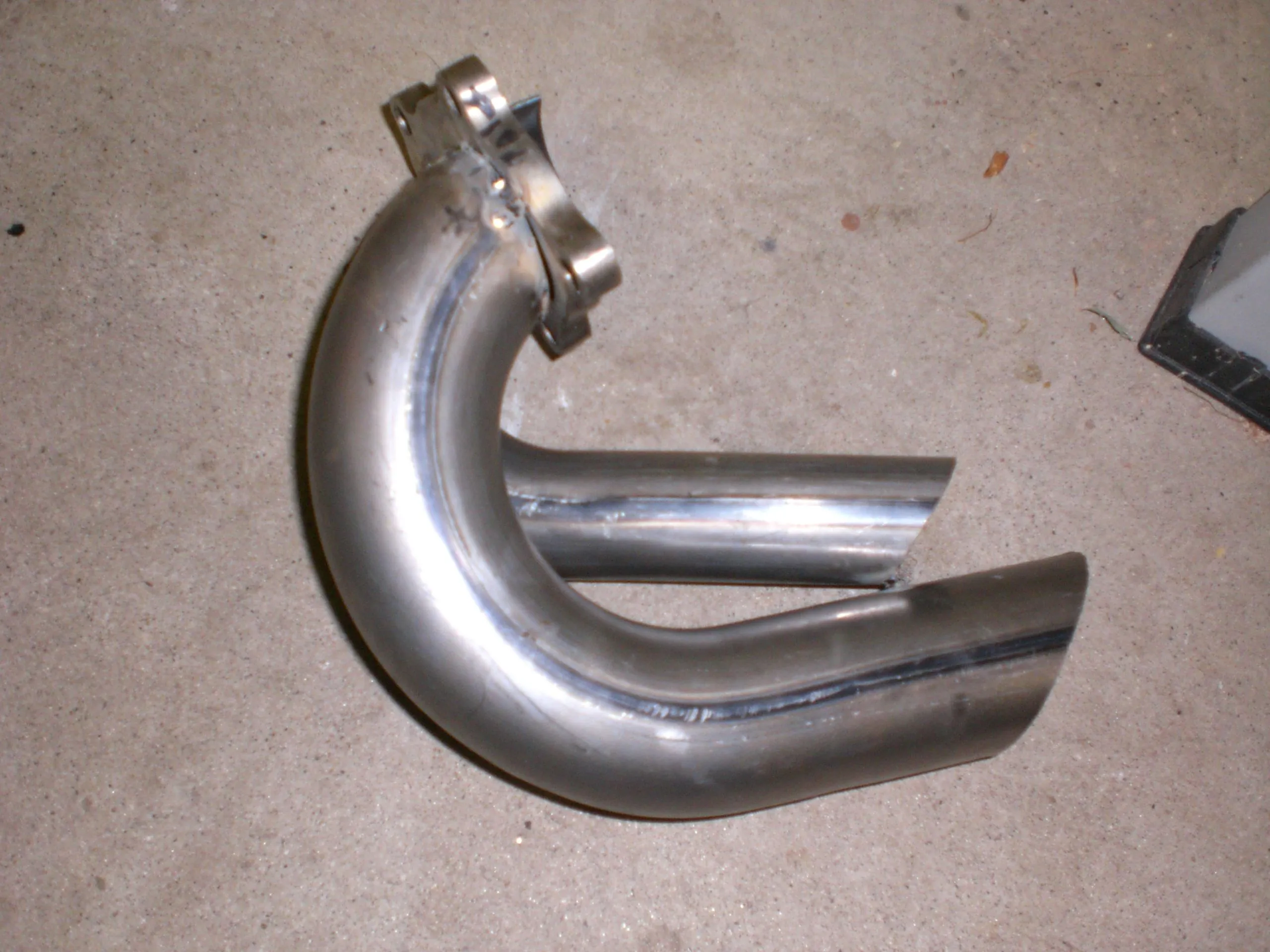

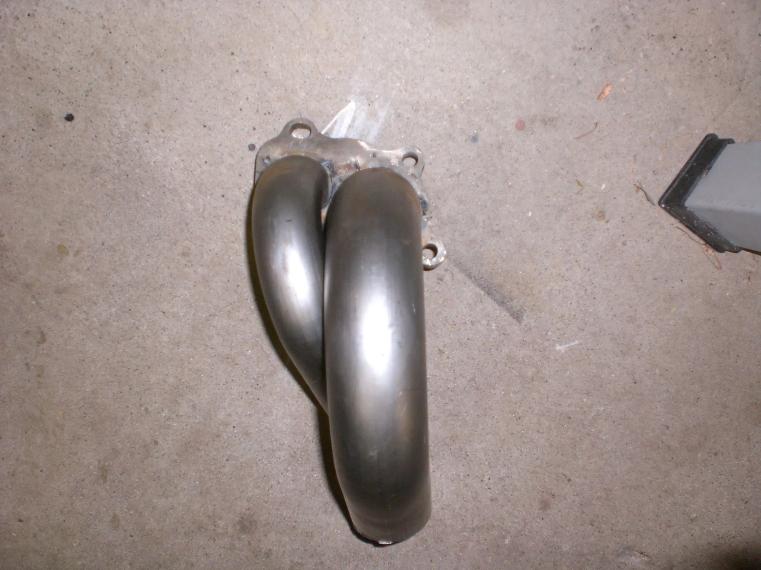

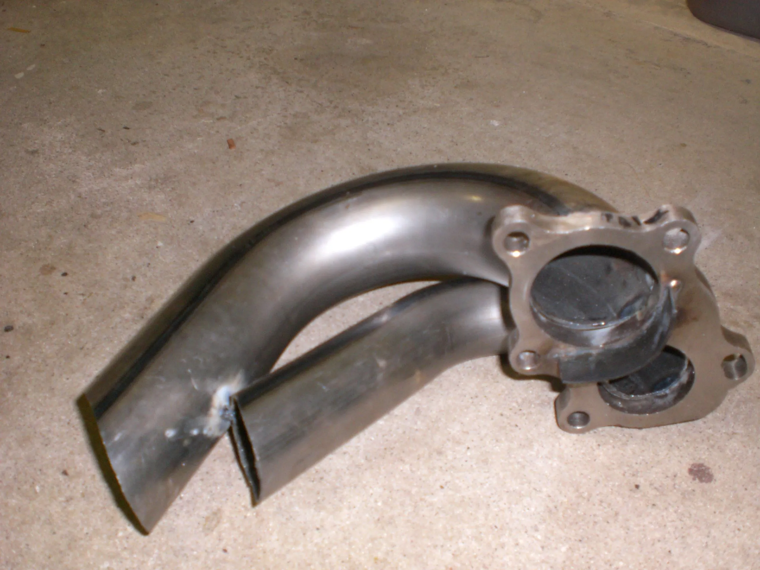

Got a little bit further on the dp. tomorrow it should be done. ill have pictures of the fitment and how its a little easier to bolt up.
