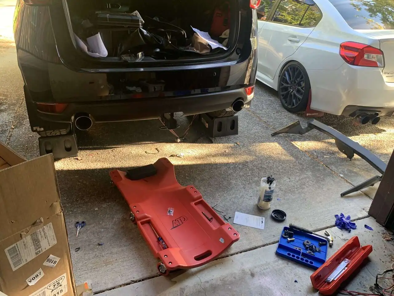

Pulled the trigger on the Curt #13315 (Class 3, 2” receiver ($160)) and installed (by myself, 3 hrs, with ratchet tiedown and and non-ratchet surfboard tiedown/strap, recommend a hoist and/or a helping hand), there appears to be adequate clearance and so far no rattle!
The real test will be tomorrow morning’s cold start. Will keep you guys posted!
