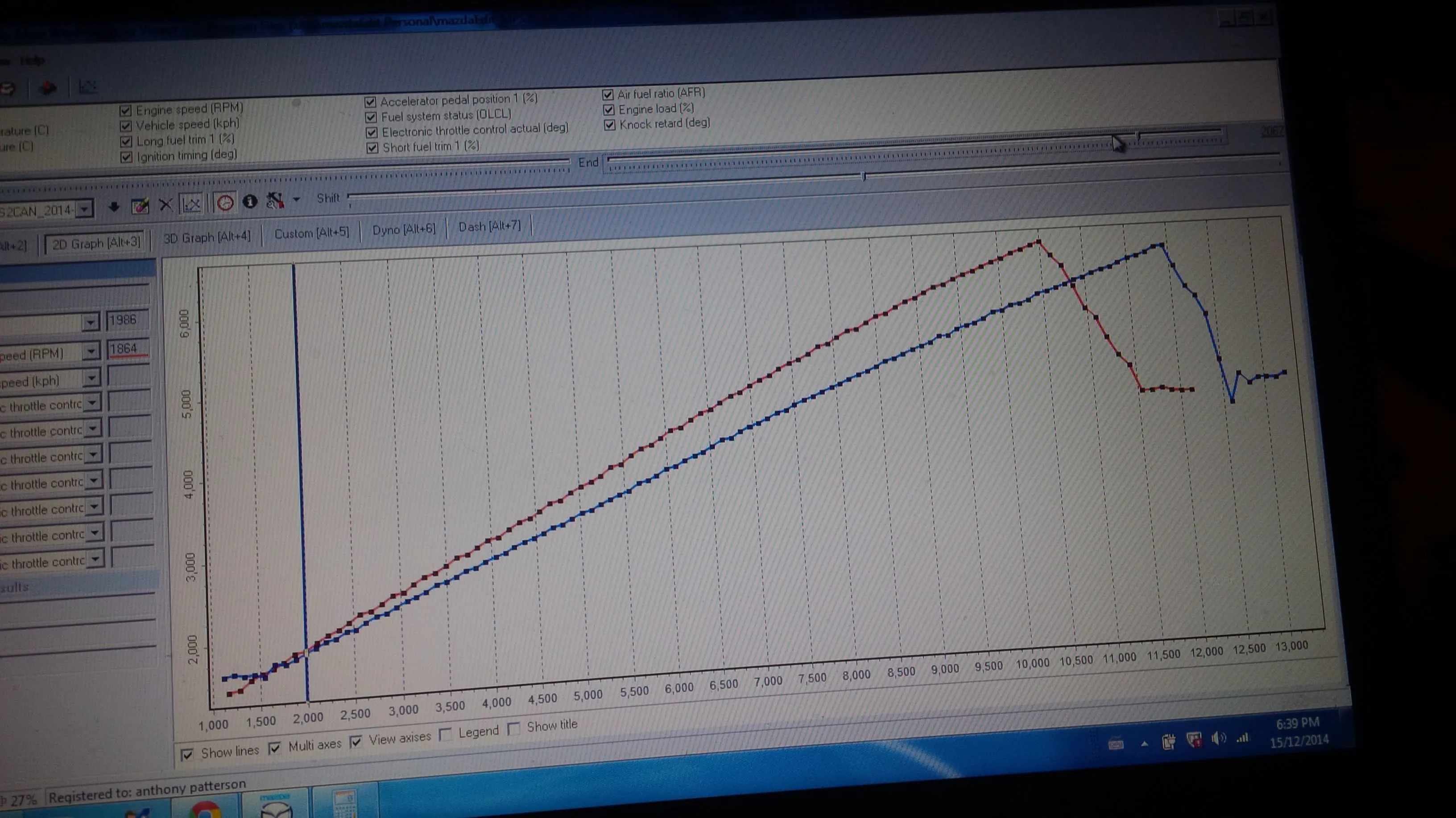

2nd gear from 20 to 100 km/h Blue is the first tune red after the second tune. There is a difference of 1.8 seconds with the second tune doing it in 9 seconds flat. It just keeps getting better too.
