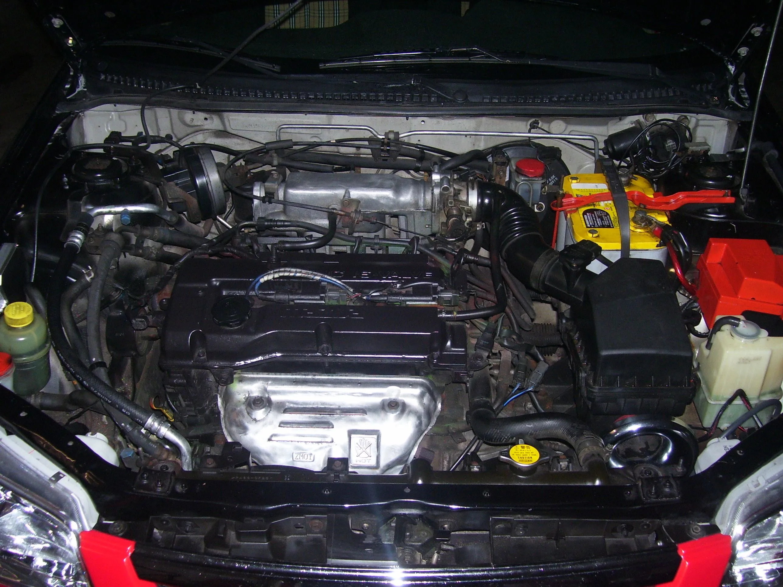

Insomnia sucks. But here's my current engine bay, after a Stage 60^100 weight reduction. The head was milled so thin, it doesn't even look like it's there, anymore!
Arharhar, I'm so funny.

I had to change the speedometer cluster so it's reading 60k but it's actually 206k miles on the original engine.I've gone through a trans and a clutch.By the way,I bought the car new in 99.
