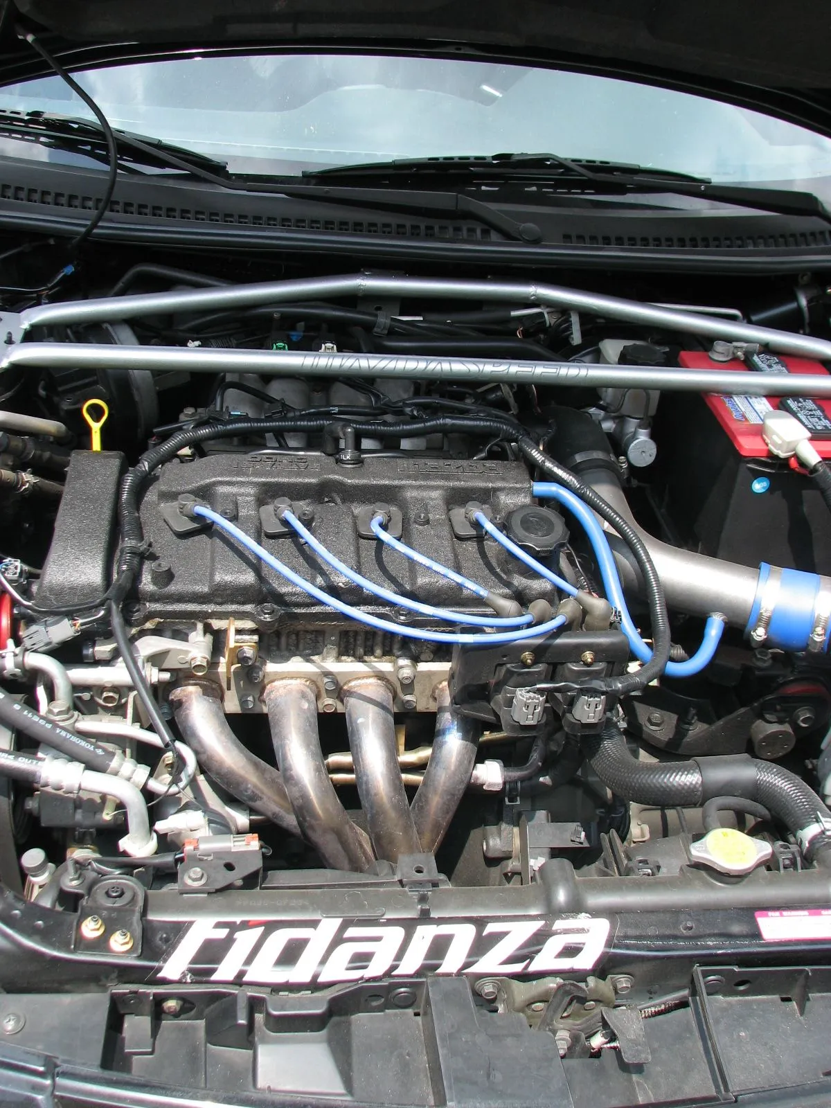

if its the coil packs, then change them soon, you WILL melt your cat if your driving the car around and its missing, find someone local to alloe you to switch, 3min job, then drive around the block to see if it fixes the problem, if so the you have options,iv replaced mine with a coil pack from a 99-00 protege/miata and then ran miata plug wires, this is a small upgrade in performance, but the stock P5 coil packs fail ALOT.. search the forums on this, you will find a how to.. i got the coil pack from rock auto for about $60, though they had to order it.. NGK wires for $40

i already replaced mine and it works perfect, also, i dont have emissions in my county so im ditching my cat soon.
