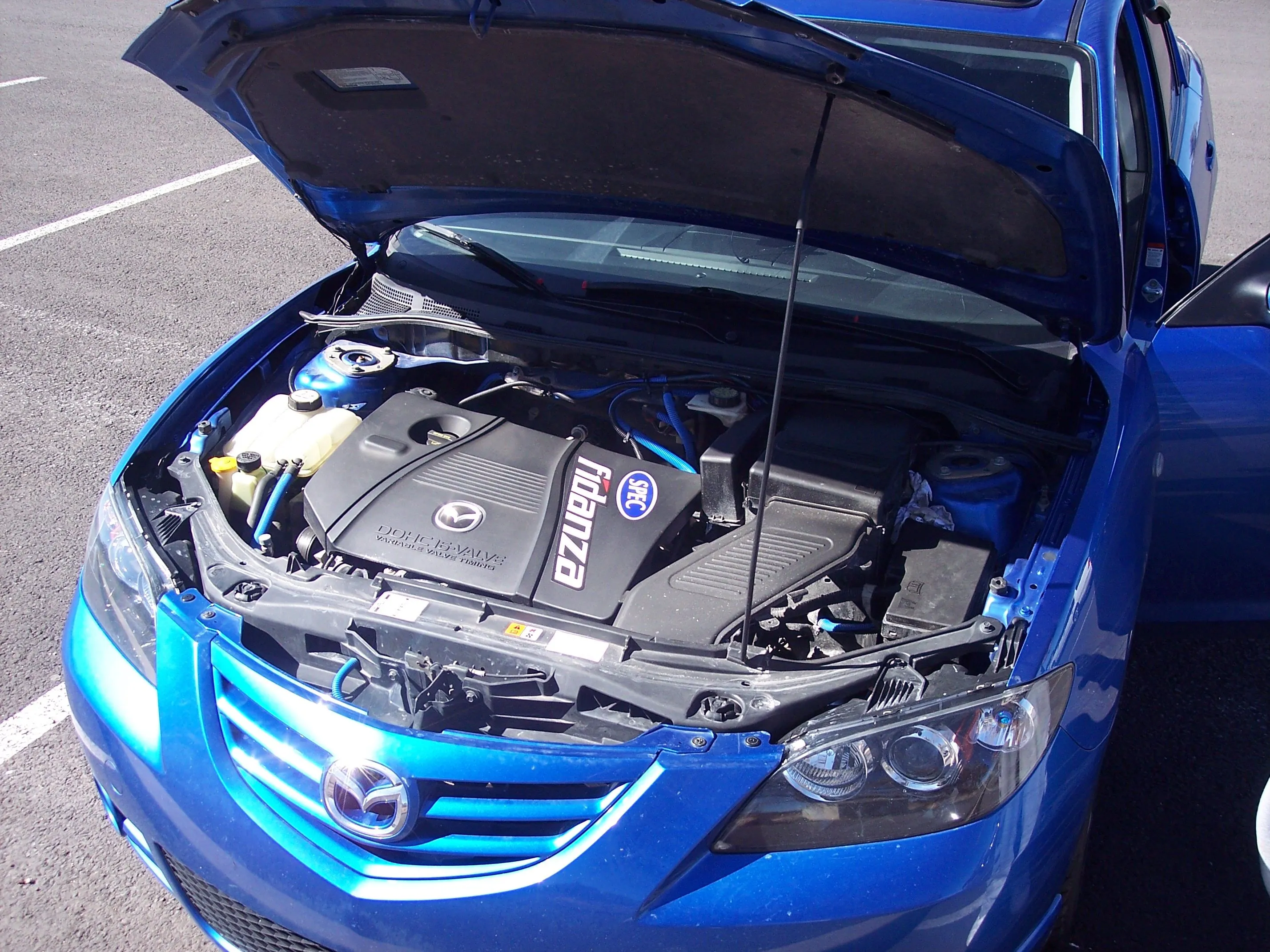

I was in the middle of the desert in Az and busted the drivers side motor mount and the left side of my engine was hangin WAAYYY low. It was pretty bad. Heres a pic of it...

Holy crapola. I would not want to be in that situation.
Yeah tell me about it, i was at the grand canyon when i took that vid. I think i made it 60 miles to bad flagstaff and got it fixed.
