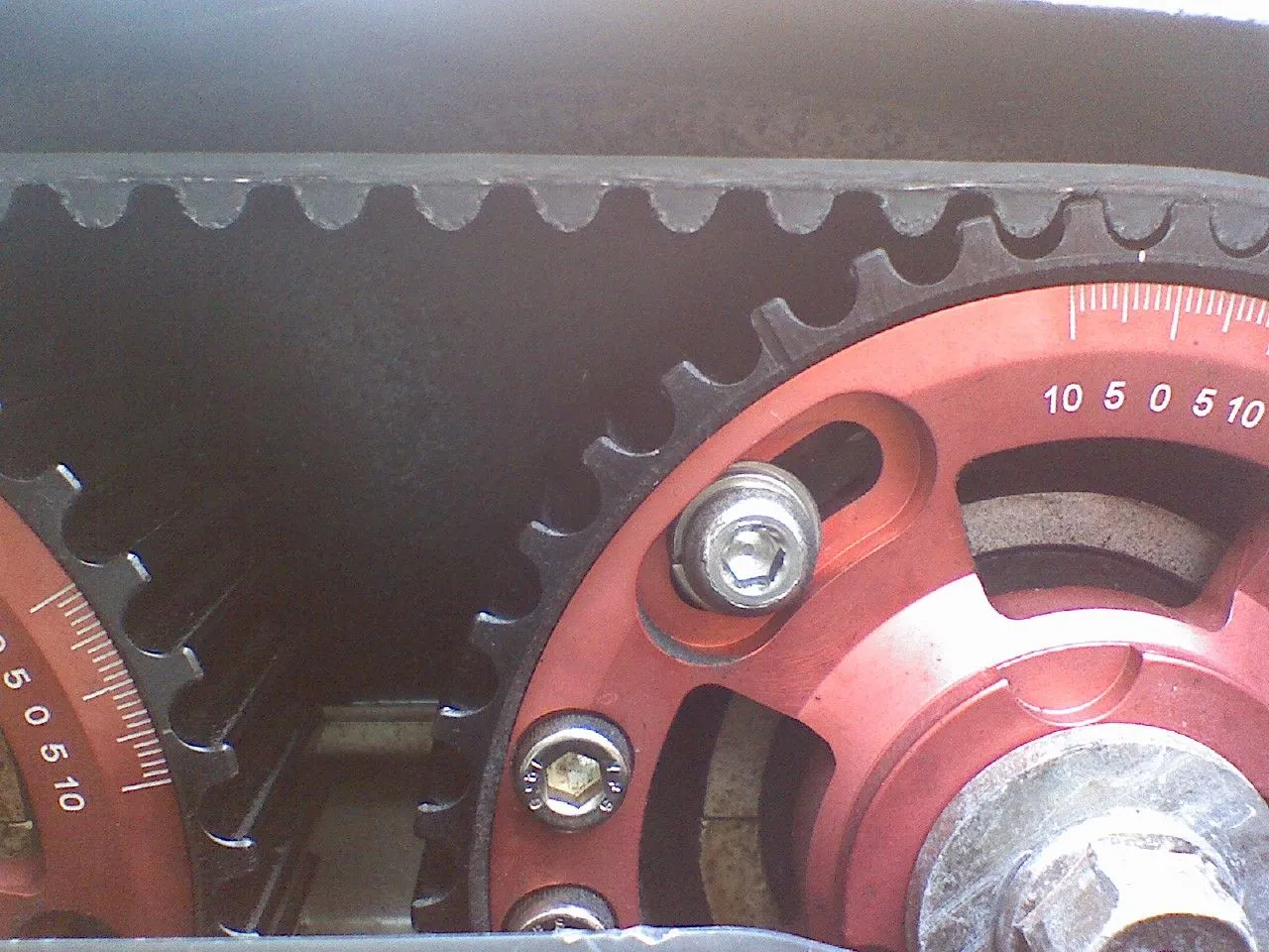

Well, I am now running my cams as follows:
intake retarded 6 deg
exhaust advanced 4 deg
Idles much better now. CEL even went away for a minute!
Trying to get passed state inspection.
Tried higher idle and misfire goes away. But returns at regular idle rpms.
I should also mention that my head has been Decked so some milling has been done.
Big difference, the engine idles much more smoothly now.

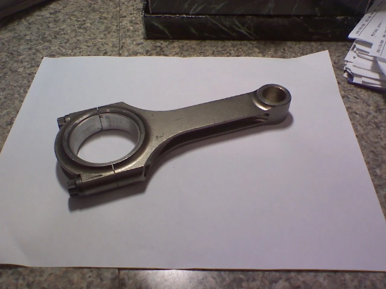

Today, I the used K1 long rods arrived. (mj)

Which cams do you have, the N/A or the F/I? I'm thinking about installing my cams here shortly but I keep reading horror stories about bad idles and misfires. If there's one thing I can't stand it's CELs and now I'm worried they're inevitable with these cams. Even though I have cam gears I was really hoping not to have to play with them too much. I actually wasn't even going to install the exhaust cam due to the pickup issue. Any advice for the install?
Oddly enough, I have the NA cams
I also planned to dial out the 11 deg overlap when I gets me terbow installed.
What I didnt plan on was the the head may have been milled even prior to when I had it decked. Casting tolerances off the line, etc...u get the picture.
So we had originally dialed in the gears to account for some reduction, but it has actually responded very nicely to the new bumps we made. I don't think the power dropped too much, maybe a smidge. But it more than made up for it in the "crispness" of response and much gentler idle, less jerking vibrations.
so I guess zeroing in even a properly pinned cam is still an "art form"
I'm sure there are LOTs of improvements still to be made.
The cam gears DO NOT appear to be dropping any signal that we could find. So I WOULD try the exh gear too IF u think u might need to do any competent cam fine tuning.

Okay, so the idle is better but you still have a CEL? I'm curious as I wonder if this might be caused by the pickups being adjusted when you adjust the cam gears. It's going to be an annoying process because I don't have a cutout in my valvel cover and I really don't want to screw up the nice powercoat I have.
so you're thinking the screws are ok now? you replaced them though...didn't you?

Also, running a spacer on CPS to bring it closer to pickups.
Pickup screws remain unchanged.
Cutout should be easy to do. We're running a spacer to move sensor within a closer tolerance of the pickup bolts. Signal is fine now.
