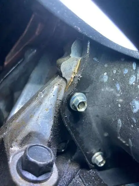

I was able to take a mirror to see the back of the cylinder heads and saw no residue, however I did see this where the manifold attaches to the cylinder, could this be it? Did not have time to take the tire off to check the timing chain leak but looking down in that area I saw nothing as well.

No, you need to be looking quite a bit lower on the backside of the head. If you look down the backside from there, you'll see the exhaust manifold heat shield which is held down by 5 bolts, and also has the upstream O2 sensor coming through it. That needs to be unbolted and lifted up slightly in order to be able to see the leak area which is located underneath it.

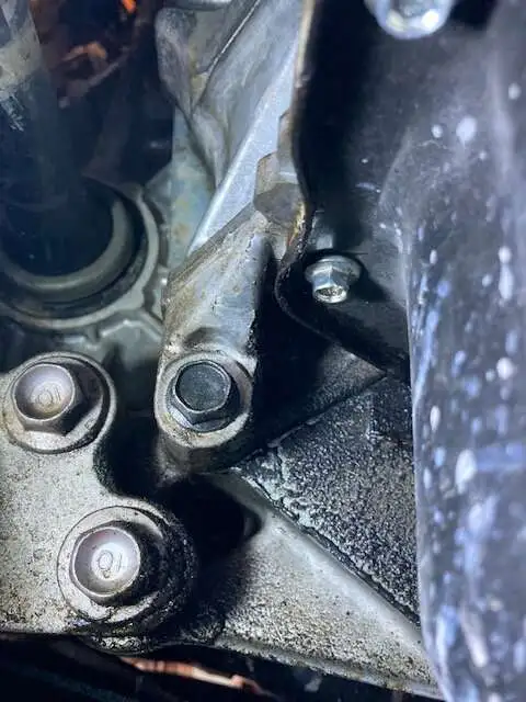

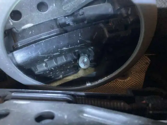

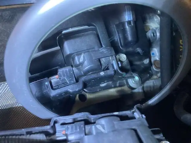

Okay so nothing behind the heat shield, have not looked behind the fender well, may do that today while changing out the front brakes. With nothing behind the shield, I opened back up the oil filter cover and looked better up in there above it and see no oil residue at all. The only place I see it is near two of the bolts on the oil pan, I tightened them slightly while there. It also looked like some oil reflection off the light between the bolt and pan. See picks below. One is the cover where its been coming out the other two are the two bolts and oil residue by them. Is the oil gasket a fairly common issue with the CX5 as well?

Assuming you're asking about the oil pan gasket, the answer is no, I've rarely seen reports of that leaking on a newer CX-5. But I'll also quickly add that it's not impossible to be leaking there either, and it certainly could be on your vehicle. The brake job will provide a great opportunity to inspect quite a bit more of the engine. Make sure you support the vehicle with jackstands before going underneath, and don't just rely on the jack. Then you can remove the passenger wheel well shield, and also the full second underbody panel. Both come off quite easily, with not that many bolts holding them on.
If you're still unable to determine exactly where the leak is coming from, even with both of those covers removed, then completely clean off all of the oil residue that you can reach. Then, after buttoning it back up and driving for a few days, inspect again for new oil, removing whatever covers you need for good access. You shouldn't wait very long to do the follow-up inspection because you're trying to find the very first sign of new oil coming from the source of the leak.
One other thing I strongly recommend is to not tighten any bolt if you don't have a torque wrench and the torque spec for that bolt. Some bolts (cover bolts in particular) have VERY low torque installation, and it's all too easy to overtighten and create a brand new and potentially bigger problem than you already have :rolleyes:
