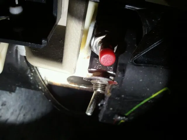

I just bought this car not too long ago (its a 2007 mazda 3 sport I), so i didn't know where the ODBII port was, i was looking around under the dash, and i noticed these two loose switch's beside my hood open leaver, one is a left-right on, off switch and the other one is a little red button. Ive never seen this before so i have absolutely no idea what they are for, they look like some bomb arming device to me, hahaha. Ill post a picture so you guys can see what I'm talking about. I'm not sure if this is in all 3's but it doesn't look like it to me.
Here it is.
attachment.php
Thanks In advance everyone.

I can tell you without a doubt those switches are not "stock". I would get those traced out and eliminate them if possible. As for your ox sensor, IIRC it is accessable from a creeper.
The red button is for the secret NOS, and the switch is to purge your nitrous system.
[Don't take that seriously. Rofl]
