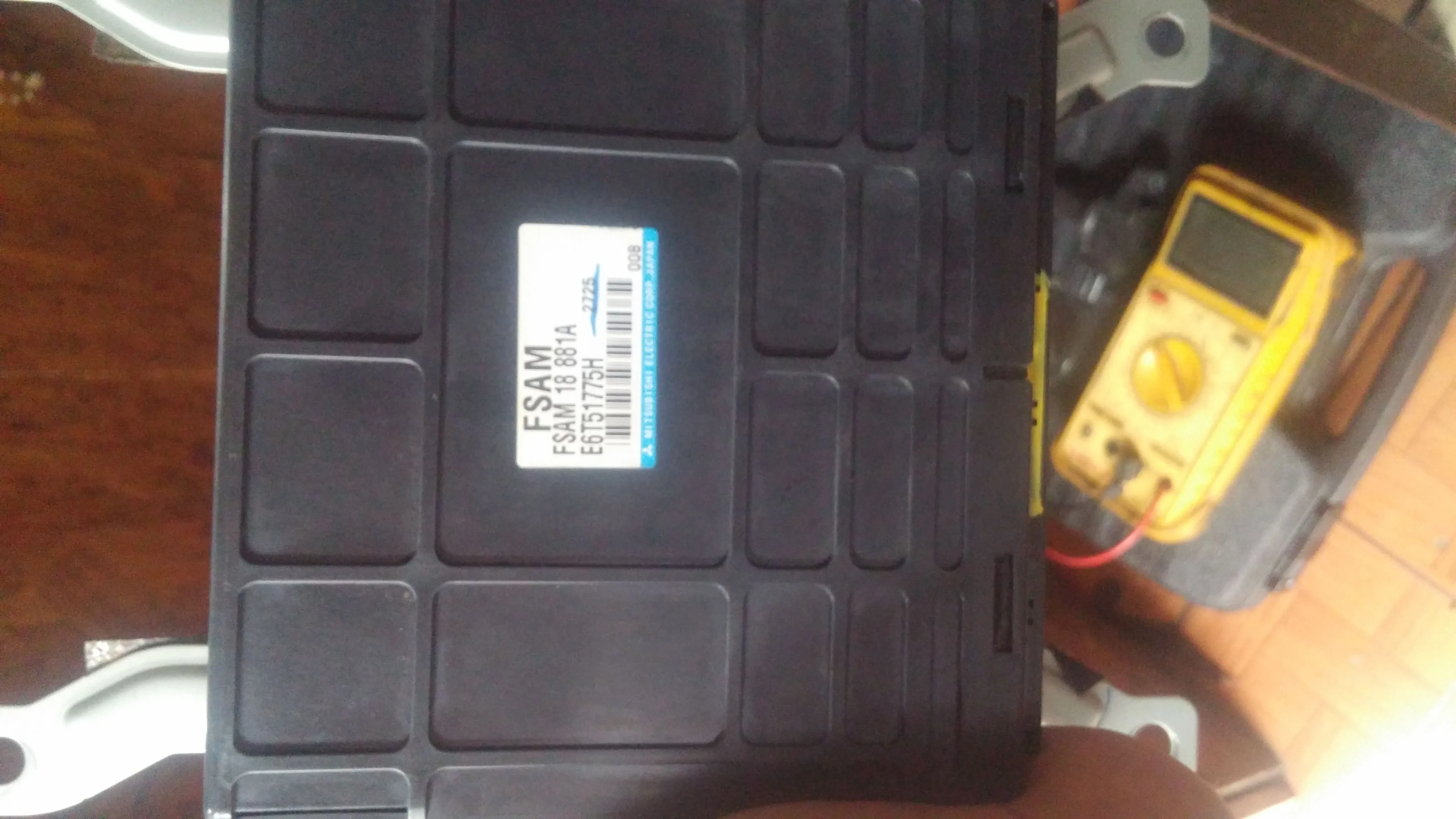

Current model computer FSAM -18 881A

Side note. What is the model year and trim of your car? I don't recognize that model number and your ECU looks different from my 02 p5 auto ECU and my manual ECU.

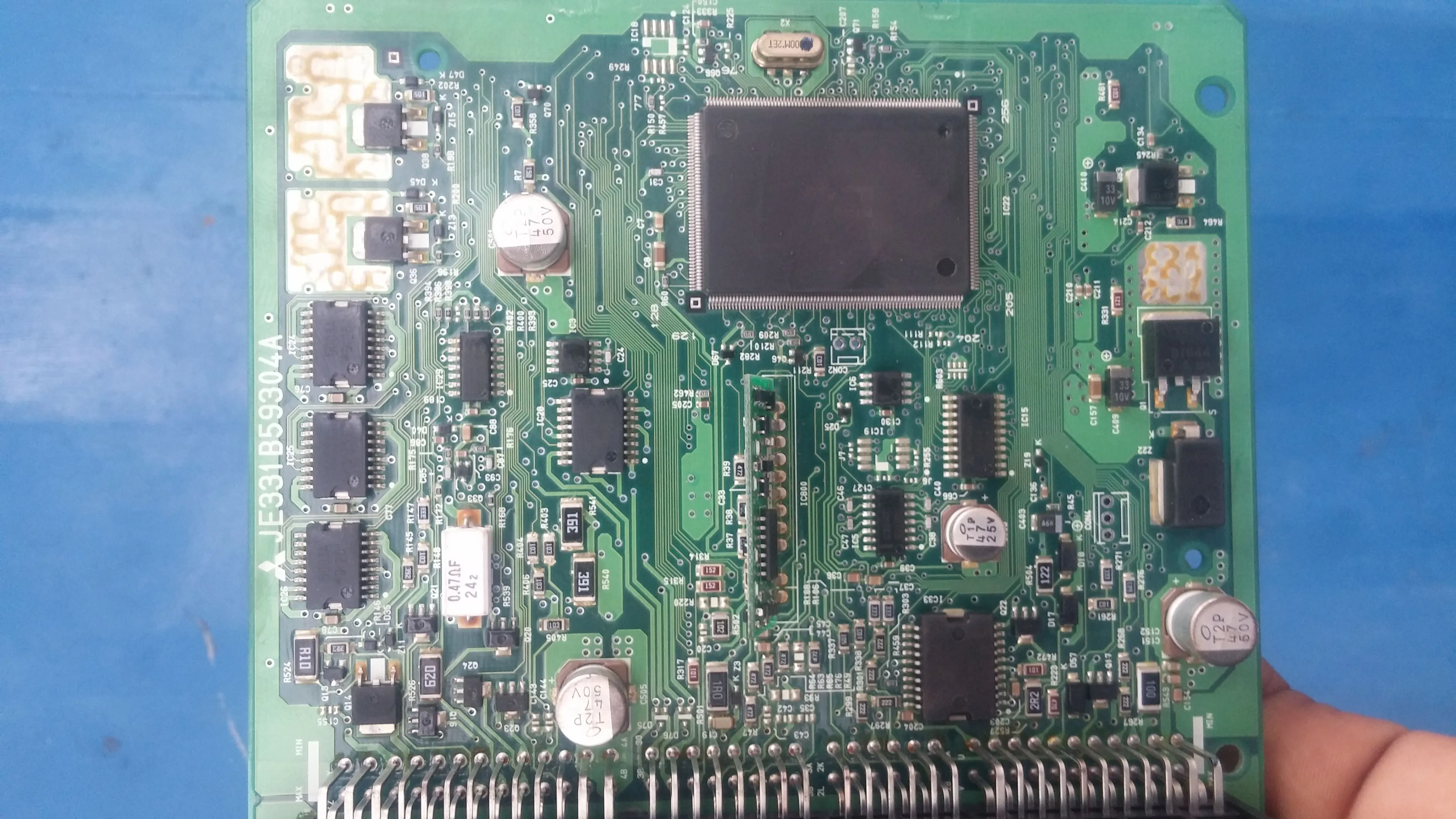

Yes i did open the ECU and they're saying its the C339G IC Blow.
