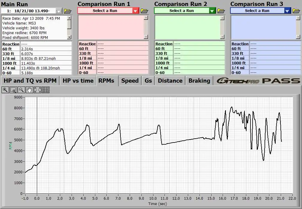

BTW: A good launch control would be a fabulous addition. But flat shifting is already there in the stock ECU's soft rev limiter. The first Car and Driver test on the MS3 even quoted a Mazda engineer recommending this for strip runs, saying go ahead, "it won't hurt." Here's an accelerometer run on my own car showing flat shifting rpm spikes going into 3rd, 4th and 5th gear. Disregard artifact at end. This happens on that device at the end of a run. Don't get a tune to acquire flat shifting. You already have it if you choose to do so. Not saying a lot of it is good for the life of the clutch, lol, but it's not a software concern.
