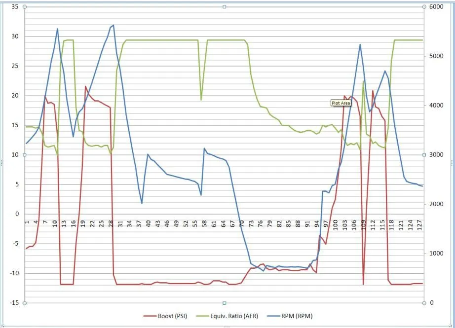

I hooked up my shiny new Cobb AP and did some datalogging after flashing the Stage 2 +SF 93 v101c. Below is the graph of a couple runs. From what little knowledge I've gleaned from the forums so far, the log looks like everything is OK, though is the boost supposed to spike that high (20-21.5) when the map says the target is 18.5 (+/- 1.5) peak, tapering (it does taper as expected)? And how do the AFRs look? I've read AFR should dip to around ~11-12 during WOT... which is right where I'm at; is that the general consensus?
Oh, and KR is at 0 for the 7 minutes I was driving, except with exactly six, single datapoint pings to 0.7 occurring (no higher), I couldn't hear or otherwise detect them other than in the log...is that acceptable and expected sometimes, or excessive and dangerous?
Any more interesting comments on these results or things I can log/compare/look at?

You need to look at your boost targets. I've seen spikes of 20psi for split seconds but return to my target with a Stage 2 map. Temp and humidity will play some factor in that as well.

I'm just happy to hear my old Cobb AP is being put to good use! Glad everything went well.
Great- thanks for the reassurance on the 20psi initial spikes guys :) All the other data seemed to indicate there were no other troubles... AFR on target, KR 0 except for a rare 0.3 or 0.7 split-second point. And Atryu thanks again for the AP, definitely using it and having some fun looking at the logs.
The graph I posted was logged about 10 miles into flashing; I logged again last night after another 40 miles or so of driving and boost spikes stayed <=20 over 25 minutes of driving and tapered to ~18 as expected. I will post a csv sometime later for kicks (left the AP at home, b/c I really need to get some work done today.. grr)
