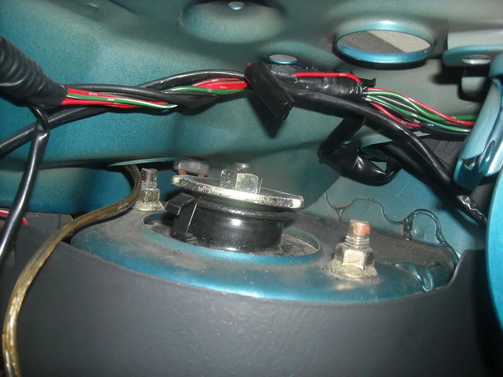

Look at the pic - the silver washer/nut combo is moving up from the black cap when the car is in motion and when it comes back down, I get the clunking sound. I removed the shock/spring assembly but everything "seems" fine. Is there supposed to be a rubber silencer in there or is the shock bad?

Make sure to tighten that nut down all the way. There's no spacer, it just has to be as tight as possible. Easiest way is to take it out of the car and tighten it. If you can't do thatm get a small impact gun and hammer it down. I had the same problem when I replaced my suspension, I didn't tighten it down all the way.
