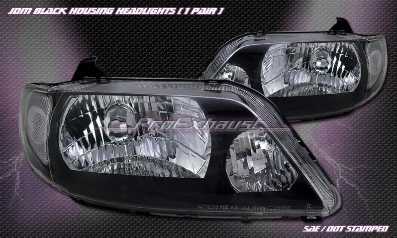

Considering I've got side-markers coming my way, my 1st thought was getting rid of those fugly ambers...eBay was my first solution, but I figured someone on here had a better/cheaper solution...that's where carbonkid's kits come into play --> kudos on him for putting so much time for this community in developping this kit...
However I'd like to see if someone has material that's a little more clear and would blend in better rather then sticking out (as some old posts in this thread have mentioned), as depicted in the attached pic.
In case someone decides to throw some legal BS my way, the eBay seller for this particular pic is ProExhaust.
