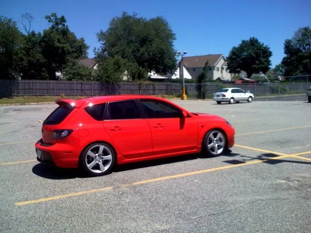

I am interested if these would fit. I have a set of Enkei RPM2's in 18x8 +35 with 245/40/18 Azenis 615s that are on my RX-8. I'm getting RPF1s 18x9.5 with 275/35/18s for my 8 so I want to put the RPM2s on my MS3. Hoping they fit by my wheel/tire calc says they will stick out 32mm more than stock. Let me know.
I have the the Rx8 wheels 18x8 the stock rubber 215/45/18 and the coilover kit and there is little room for a wider tire let alone a 1" drop on 19's. Measure LOTS b4 you take that on. It will look sick though (spin)
those wheels look so ******* good on our cars!
