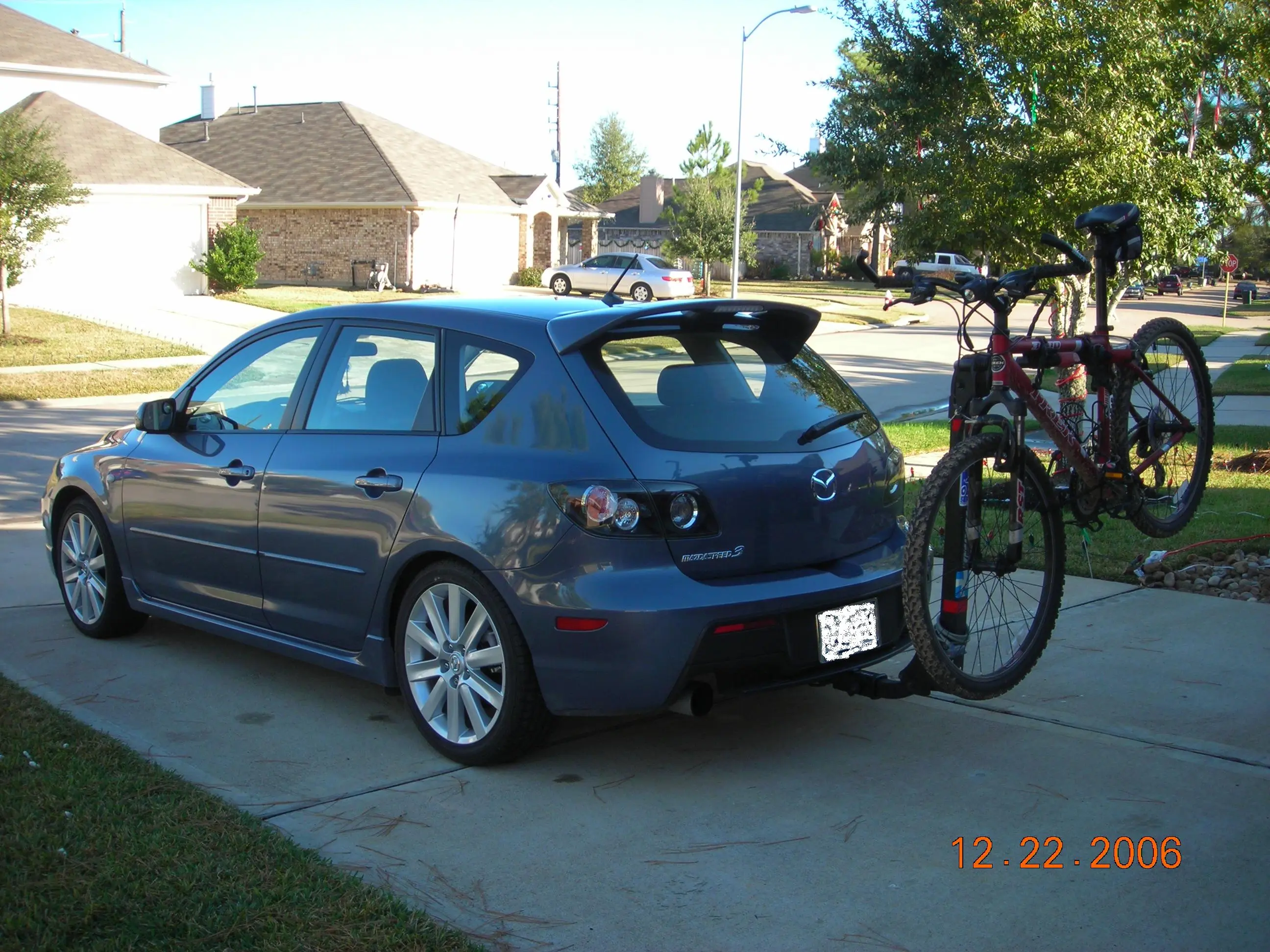

Hidden hitch makes a 1 1/4" receiver for our cars. i use it for my bike rack with an adapter to make it 2". When the adapter is not on there you cant see the 1 1/4" hitch.
If you zoom in on the pic, the big square metal thing sticking out under the plate is the adapter which is removable in about 5 seconds.
i havent done the wiring so cant comment on that but if its like anyother car should be V easy.
Hitch installation is easy, about 30 mins if i remember right you do need a round file to elongate some holes but no biggy.
