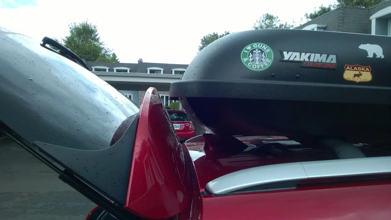

Recently discovered that my old Yakima Platinum 16 Cargo box would not fit on the Mazda with the stock rails/crossbars. The mounting put it too far back and the hatch would not open.

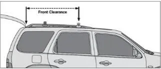

The most important measurement for Cargo Box fitment is the Front clearance. This is the measurement from the center of the front cross bar (moved all the way forward) to the point where the roof meets the hatch (when it is opened).
For the CX-5 this is roughly 45.5"
Cargo boxes from the two major brands Thule and Yakima that fit the CX-5 are listed below.
Thule Sonic L 634 - (13cu/ft) - 44" Front Clearance
Thule Force L 624 - (13cu/ft) - 42" Front Clearance
Thule Pulse L 614 - (14cu/ft) - 43" Front Clearance
Yakima RocketBox Pro 11 (11cu/ft) - 45" Front Clearance
Yakima RocketBox Pro 12 (12cu/ft) - 40" Front Clearance
Yakima RocketBox Pro 14 (14cu/ft) - 45" Front Clearance
For me it was a tie between the Rocketbox Pro 14 and the Force L 624.
I ended up with the Rocketbox Pro 14 because the local shop did not carry Thule and I was able to trade my old one in so it came to only $325 for the Yakima. I think the Thule is a much better looking box though, if they had it I would have gone with it.

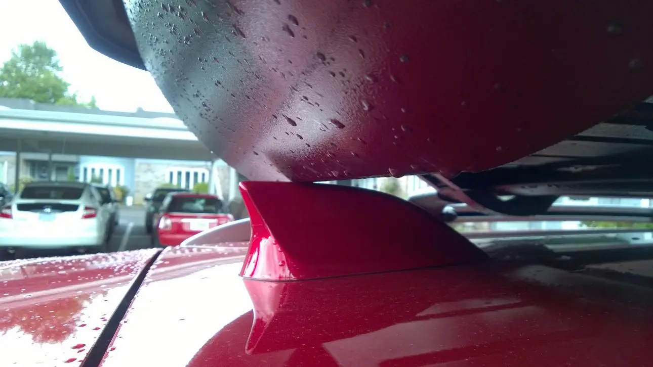

The Yakima does touch the rear antenna fin and push it down a bit, looking into getting some 1/4" or 1/2" spacers to raise the rear of the Cargo Box off of it.

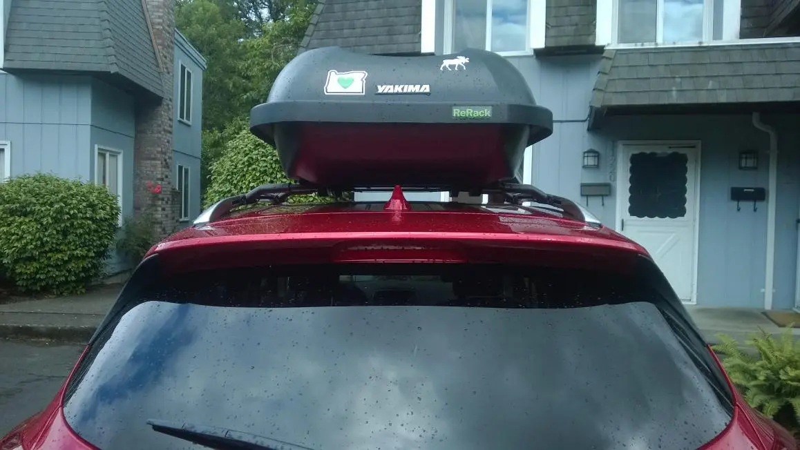

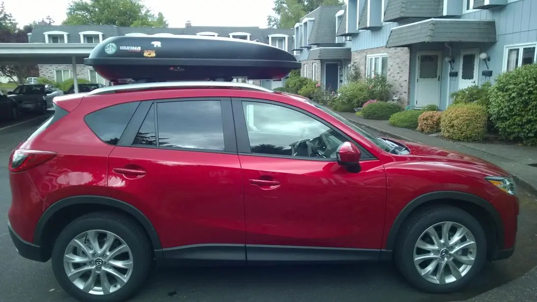

here are some pictures of it mounted.

Update to this.
There is a place in Portland, OR called ReRack. They specialize in used racks, hitches, and hitch attachments. They carry new stuff as well.
I went back there after the purchase and asked if they had any spacers, they told me they did not carry and spacers specifically but they would give me some hefty pieces of rubber that "might help".
I am not sure if he was messing with me or not but what he gave me seemed to fit like it was made for it! Result, I now have plenty of room between the box and the fin antenna, even when loaded.

Those are Thule rack pad feet - not cheap. But that's what happens when you go to the small shops. I dropped off my extra Thule parts at a local rack shop so maybe some of their customers can benefit like kevschu.
