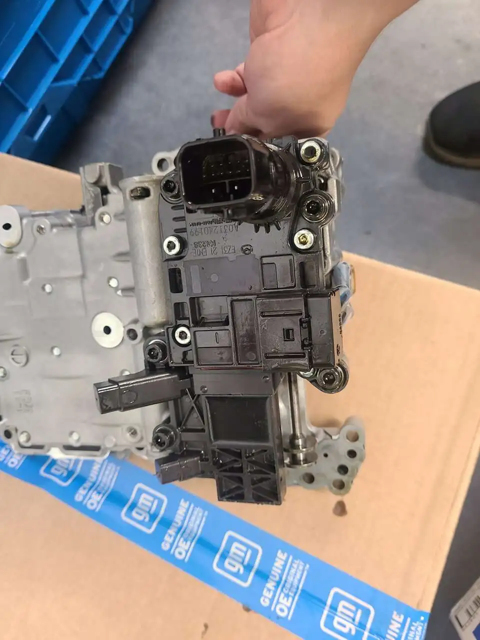

Looked at the service manual and the tcm is built into the valve body...

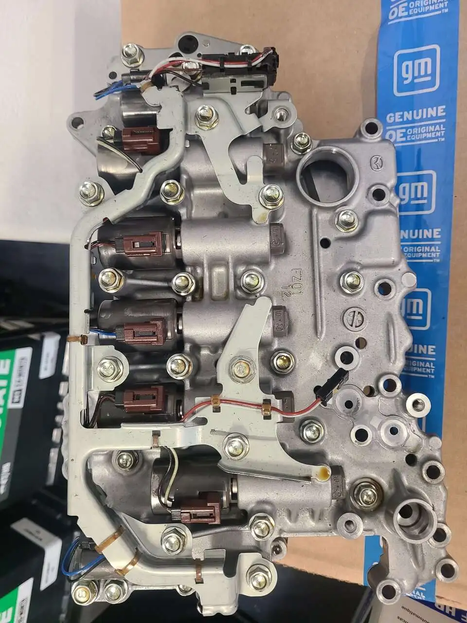

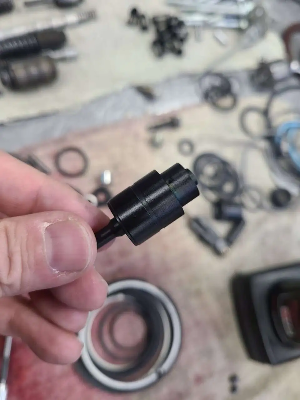

personally I would not just keep driving with a hesitation into drive like that.

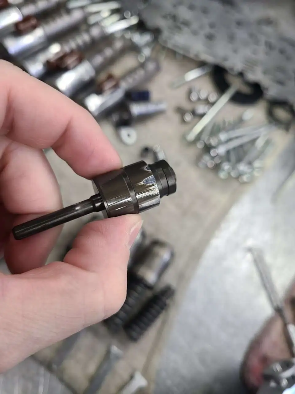

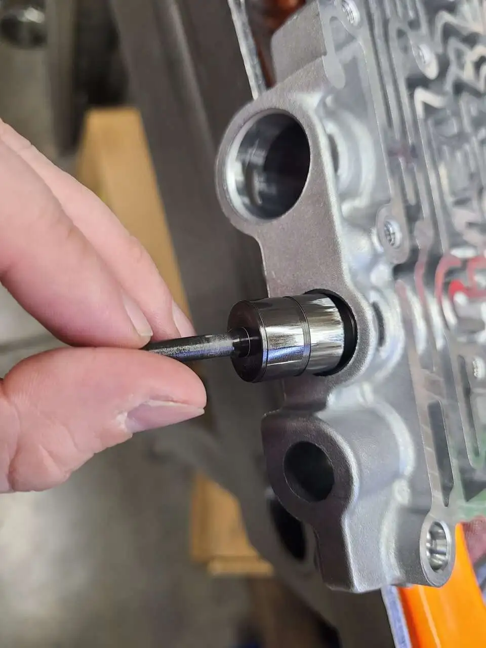

A hesitation going into drive longer than about a second or two is indicative of a pressure problem inside the transmission. This can be caused by multiple issues. Some of the concerns that can cause the delay are pump wear, this is not likely due to how the pumps are built in the Skyactiv, if this were the case you would need to have an overhaul as it would burn the clutches very quickly and all your shifts would be bad. Fluid level not being correct can also cause this but if it was just filled and they did it correctly this should not be a concern.
Next, it could be a solenoid issue but is not likely. To make 1st gear there are two solenoids in play. Solenoid 4 is sending line pressure to the Low/Reverse clutch set, this operates in P,R,N and stays on for D, so we can eliminate this solenoid as a cause. Solenoid 1 turns on and sends pressure to the Low Clutch which operates until it turns off for 5th. It could be slow to respond but that would cause a bind when shifting into 5th. An issue that we are starting to see in the earlier cars is Low/Reverse accumulator wear. We are seeing this cause delayed engagement and eventually damages the one-way clutch that the Low/Reverse clutch set rides against and has uneven apply pressure on. This causes pressure to bypass the accumulator and take time to charge the circuit.
Mazda only sells the TCM and valve body as one unit and it needs to be programmed. Most dealers from most OEMs will not open a transmission up to find the issue because they are not trained on what to look for and it can be a very time consuming process. They could try a valvebody/TCM combo but that may not be the issue and you've spent a few thousand only to need a transmission replacement because they don't do internal repairs at the dealership. First pics are the valve body and then the TCM on top, 3rd and 4th pic is the Low/Reverse accumulator wear and the 5th is the repair, you bore the hole bigger and replace with a larger anodized valve.
The video is a link to a CX-5 we recently built that had no transmission codes but had a failed one-way clutch. There were no codes for the transmission, just because they told you there are no codes does not mean there is not a problem, they just may not know how to properly diagnose the situation. I would keep an eye on it and monitor if it worsens. 2017 CX-5 broken transmission

I'm willing to bet it's the valve body. I suggest getting the opinion of one more transmission shop. If they also say to let it be , well.. then. Do that.

I would verify transmisison fluid level to make sure it is betwen the two marks on the dipstick at the correct temperature with the vehicle running. If the fluid level is correct and it happens on a cold start or when it's cooled down it is very likely valve body wear and as the metal warms and expands it seals better. This is very common across multiple transmission families.
I would call into question any transmission expert that believes a forward engagement of 3-4 seconds is normal, it's not. For reference the factory spec for the Skyactiv is .4-.7 seconds from neutral to drive.
When putting the car into reverse the transmission commands much higher line pressure vs a forward engagement and it's not uncommon again across multiple transmission families that are experiencing wear to have a normal reverse engagement vs delayed forward.
I made a video awhile ago about how to put the transmission in learning mode. This will force the transmission to start over with new values, this may effect a change for you, it may not.

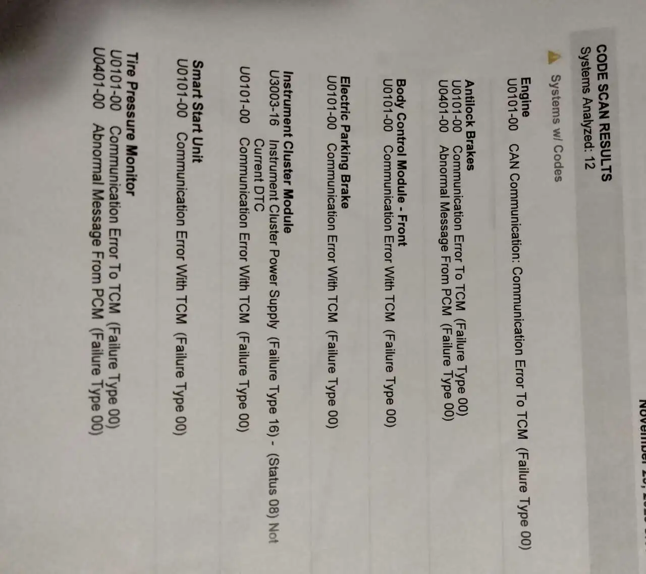

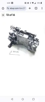

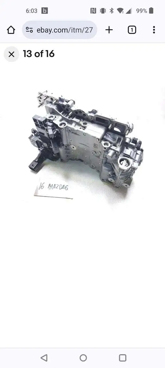

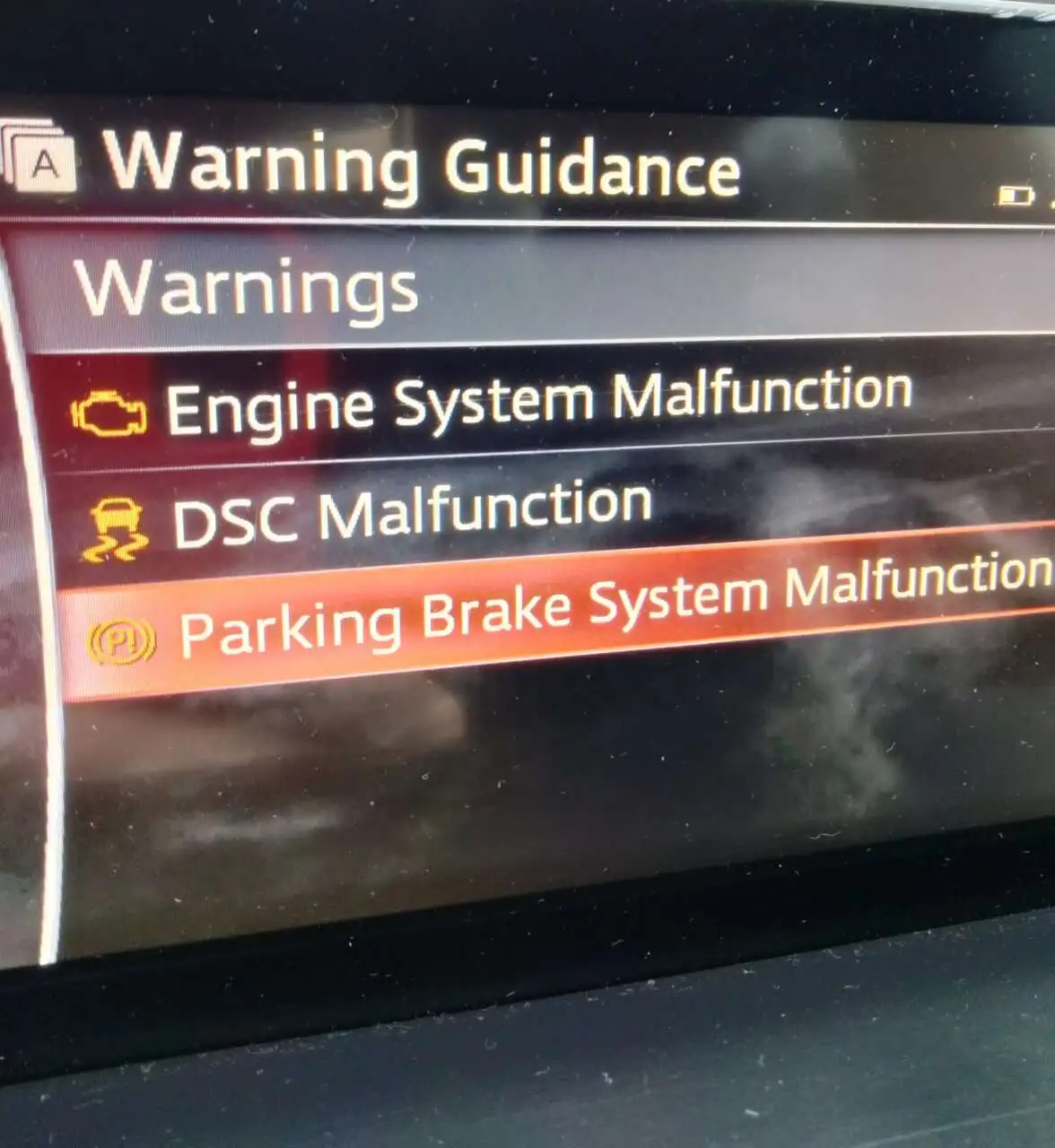

Unsure if you've moved forward or not but I will also say that the tcm is indeed built into the valve body and the valve body is likely the issue. I have a 2016 Mazda 6 and the tcm is on the fritz. It will throw at, parking brake, engine, traction control lights randomly, go into limp mode randomly, and have the start button flash red and refuse to start occasionally. Every code, from engine light to the abs code is all tcm failure or lost communication with tcm. And it is an entire valve body and tcm assembly that needs replaced. I've reset the transmission, I've unhooked the battery, ECT. It'll drive fine for a week then freak out again. I even replaced abs sensors in case they were reading improperly and confusing the computer. My Mazda dealer says they've never replaced a valve body or tcm in these cars but can do it. Aamco says they can do it as well. The issue is it will need programmed to the vehicle it is installed in. They are vin locked. It can be replaced without replacing the entire transmission. I attached photos of the codes I have, if you don't have similar codes I don't think it'd be your tcm necessary. .
