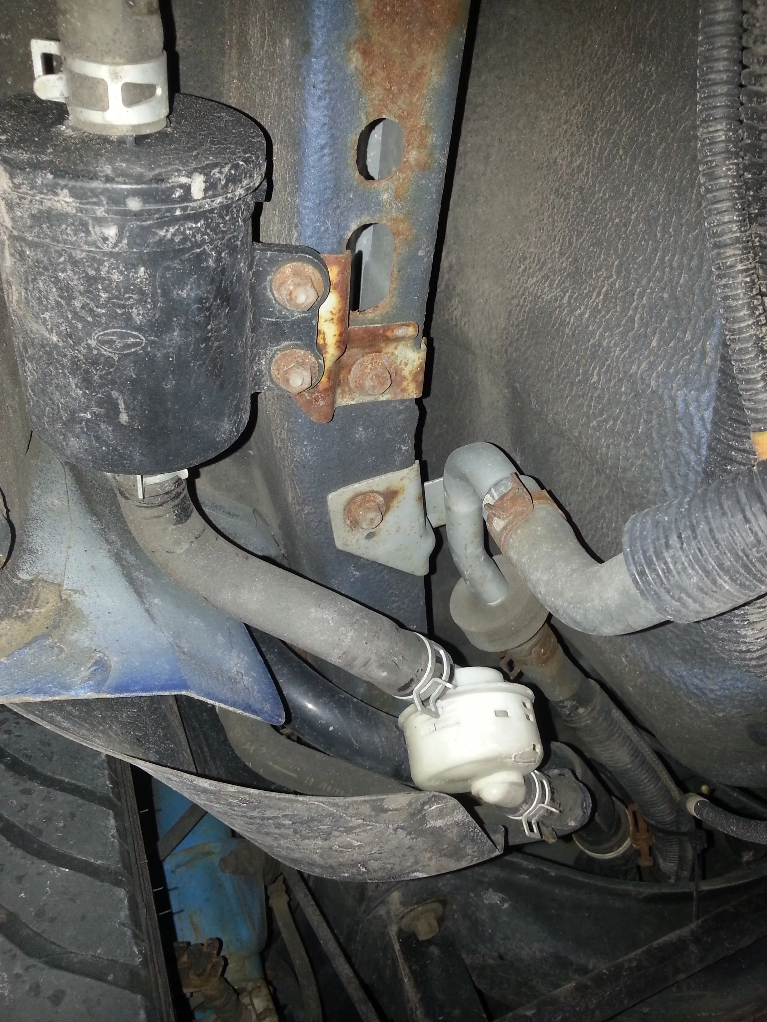

Hey it's been cold here in Missouri so I haven't got around to taking pics its should be warmer out and I'll take a few this week
I took the white thing off and the black canister both off and took an air hose and blew every hose out clean the one that leads up by the filler neck actually blew quite a bit of crap out of there. Call it coincidence but now I'm even getting better mpg!
Here u go
