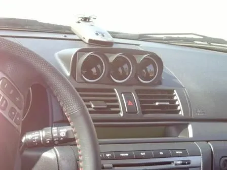

Okay, so after hours upon hours of surfing the internet trying to figure different ways to mount gauges in the speed 3, I finally came up with a decent conclusion. When Autoexe first launched their gauge pod people told me they had to paint it themselves and not only that it didn't seem to match the interior and line up correctly. I came across two things: 1; A Mazda 3 OEM DVD DIN Dash Kit Dash Kit. I also came across a DIN 3 Gauge 52mm Bezel DIN Bezel. I mean it works and all but I really wish I could find a bezel that faced straight rather then to the left. If anyone has any ideas or pointers fill me in. I did order both of them, but the dash kit is coming from Japan so it's going to take a couple weeks to receive it. Once I look at it along with the bezel and see how it matches up I'll take some photos and let everyone know.

I would, but I'm going to eventually need more then one gauge if I decide to go bigger turbo and build the bottom end (wideband). i think it's the cleanest possible for that style setup.
http://www.youtube.com/watch?v=RWyPio6xZ10 It's not very clear, but you get a general idea of what the setup looks like. I just can't figure out which bezel that is.
well yea, up top above the vents it looks nice. but in the pic with the yellow dash right in the middle. not so nice.
The angled din mount wont work cos it leaves gaps, plastic ones stick out and look crap. I bought all the din mounts i could find and only one would work but still required trimming.

oh yeah, you'll need two din mount panels, one for the front and one for the back, then when you install the gauges, the 2 din panels clamp to the dash kit. This was the only way i could think of doing it.
That's a damn shame about having gaps, I really thought it's be an almost perfect solution to getting gauges in this car without building a custom pod. How big or noticeable were the gaps out of curiosity?

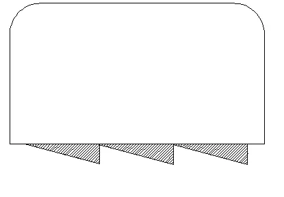

gaps are somewhere between 1/8 and 1/4" if i remember correctly (shown in dark below). Notice my black paint doesnt match up perfect, from what i have read on the other forum, the guys doing the F/G work found a paint for their pods which is supposed to match the stock interior-Info is somewhere in here.
