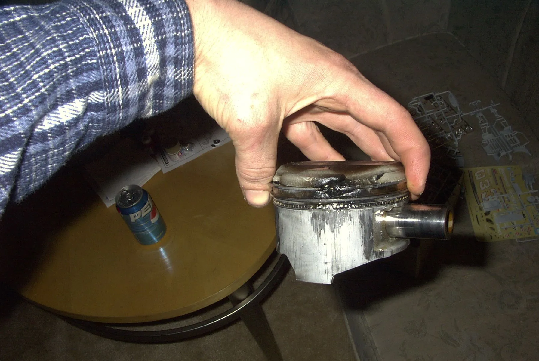

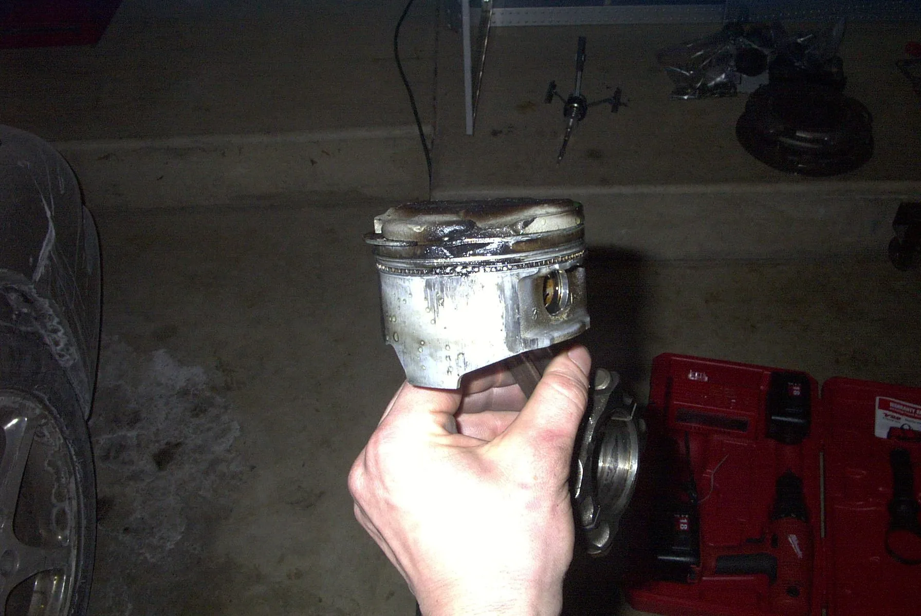

this sounded like a bent valve.
so if hes the god he is then stick the scope camera he must then have in there and have yourself a looky(usa)
There's a problem with that, he quit and went into IT work, leaving his fancy tools behind.
Is there someway to rent a scope or something from Autozone so that I can look in through the spark plug holes. Basically, is there a way to tell what kind of shape the pistons are in without removing the head?
DOH! let us know what happens. pics of course. but I would find out what you need first because there is soo many ways to go about this. It all depends on where your gona go with this,what broke, and how much money you have right now. because if you had the money you would set the block n head up for the most power even if you dont go down that road (insurance for if you change your mind in the future)
