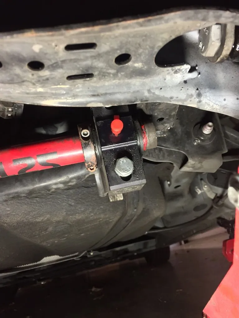

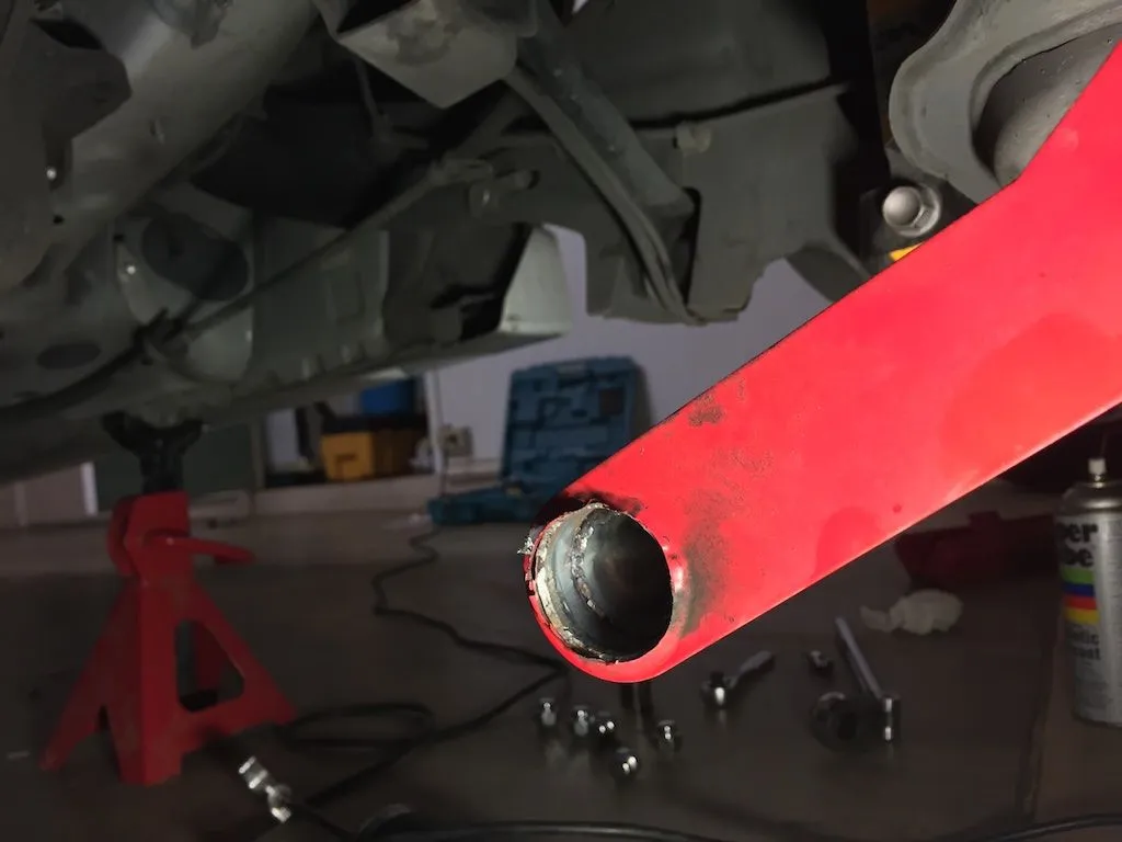

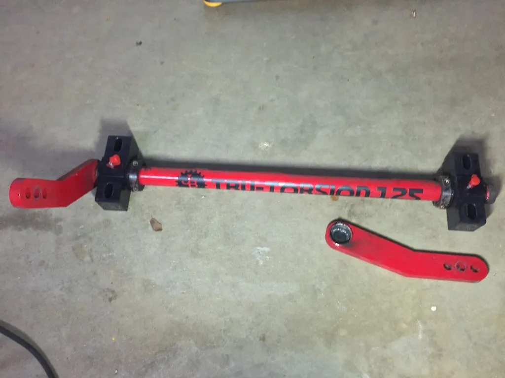

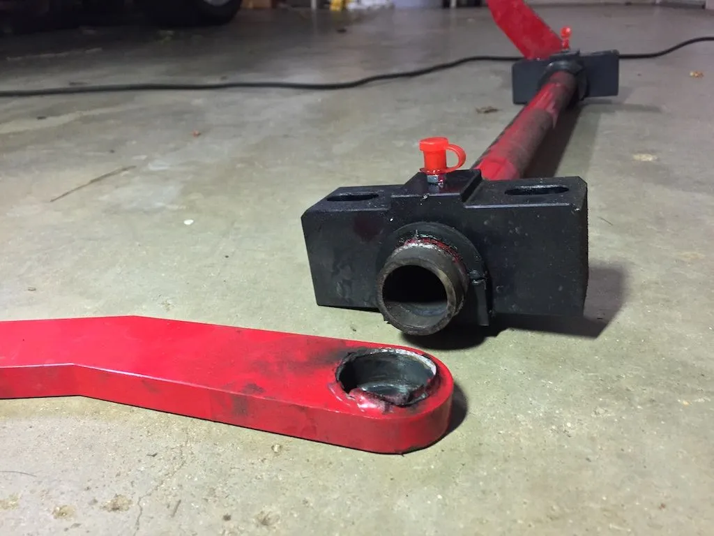

So last night while I was replacing my bad Koni shock, I notice that my JBR sway bar looks a little funny. I grab the arm and to my surprise it fell off. Per the site description "Sway Bar is TIG welded inside and out then the ends are capped." From the looks of it, the outer weld did not get any penetration and there was just too much torque for the inner weld. The sway bar is supposed to have a lifetime warranty and I just reached out to JBR. I hope we can get this resolved smoothly. I am really concerned about the shipping. If I have to cover the 100% of the cost to ship this back that's going to suck. Lucky I live Hawaii. Not! (sad2)

Swaybar on it's way! Got an email from Jamie after they reviewed my pictures...
"...I have reviewed the pictures and it's clear that we missed the outside weld that should have been performed before the end cap was welded on. This is our error and we're very sorry."

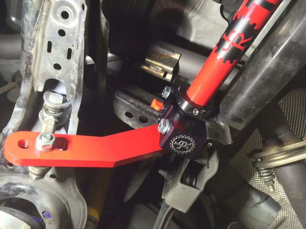

I am using the AWR endlinks. 2 things to note if you are thinking of trying them...
1. They do make a little noise because of the spherical bearing joints.
2. They are about an inch longer then stock so they probably work better with lowered cars.
