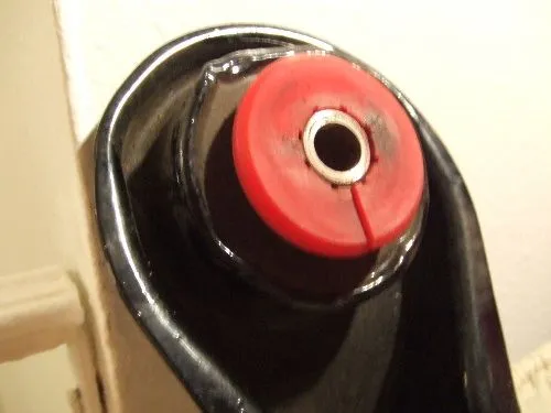

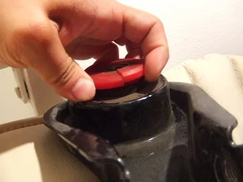

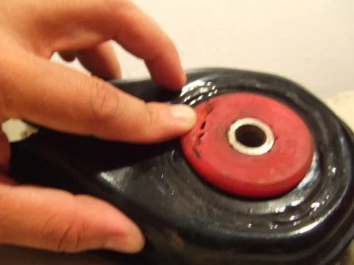

Because i had to sent the car back to the dealer, I took the AWR mount out to make sure my warranty is in effect with no problem even though it is not the mount that cause the trouble. The mount did crack and tear on one side, i don;t know if it will effect performance (i did not notice any really) but because it crack .. i am trying to see if they will replace it for me.

the newer AWR mounts have been redesigned. we brought the concern to tony when the first one broke and mailed him a broken one as well. he is going with a newer style of bushing to correct the problem. initially the problem was that a two piece bushing was used, and since they are oriented vertically, the stress on them acts differently than if the bushing were mounted horizontally as they are in all the other mounts he has designed. he has long been aware of the problem and it has been corrected.

now, no offense to mazda or this car, but if the tranny mount had broken as they have been doing, that would indeed cause undue stress on the other mounts. since the car only has three engine mounts, if one were to break, you are now asking two mounts to deal with entire power output of the engine.
it should be clarified as there appears to be confusion, the AWR mount is NOT the same as the tranny mount which has been breaking, and most of the cars with the broken tranny mount have NOT had the AWR mount in it to cause that tranny mount to break.

i spoke with Tony@AWR a few minutes ago. he will replace the broken mounts. as for replacing all older mounts even if they have not broken i'll have to ask him on that.
he buys his bushings from Energy Suspension. he has mailed the broken mount he has gotten back from us to them so they too can determine what can be done on top of everything else to strengthen the mount. so the revisions are a work in progress. AWR is considering no longer offering 70 durometer mounts for the mazdaspeed3 as he is beginning to feel that they are not strong enough to support this particular powertrain. the downside to this is that going with a stronger bushing will induce more vibration inside the cabin.
