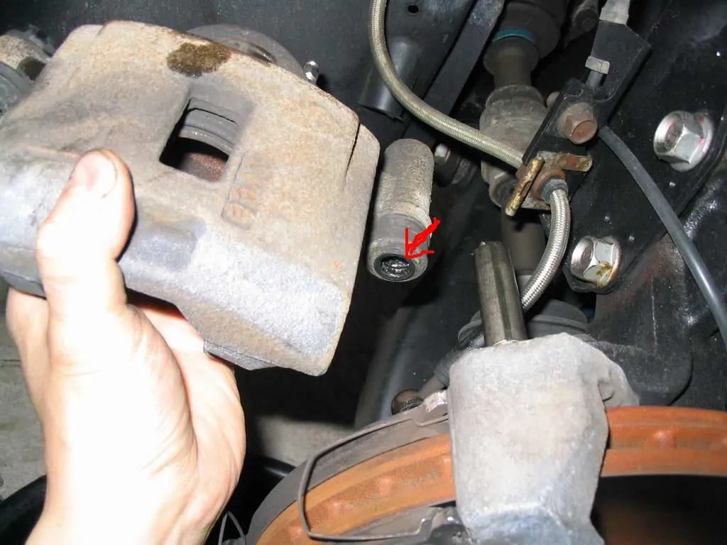

thanks for your guys help. just some questions. do you guys have pics of this slider and also, how do i replace the spring clips. i skipped it because i dont remember how to put it back. thanks guys!
any pics of the sliders so i know what they are and how do i put the spring clips back

On either end of the caliper. The pic shows the pins out, where the small black rubberseal is.

how do you remove it. i dont understand it really. when i replaced all 4 rotors, i just unscrewed the 2 big bolts that takes off the entire caliper. i didnt know there was a way just to take half of it off to get to the brake pads. does anybody have a pic of the pins or a quick how to? this would be helpful, thanks!

If you look on the rotor the other half is still there. He already pulled them apart. Thats all you need to do... pull. (first)
