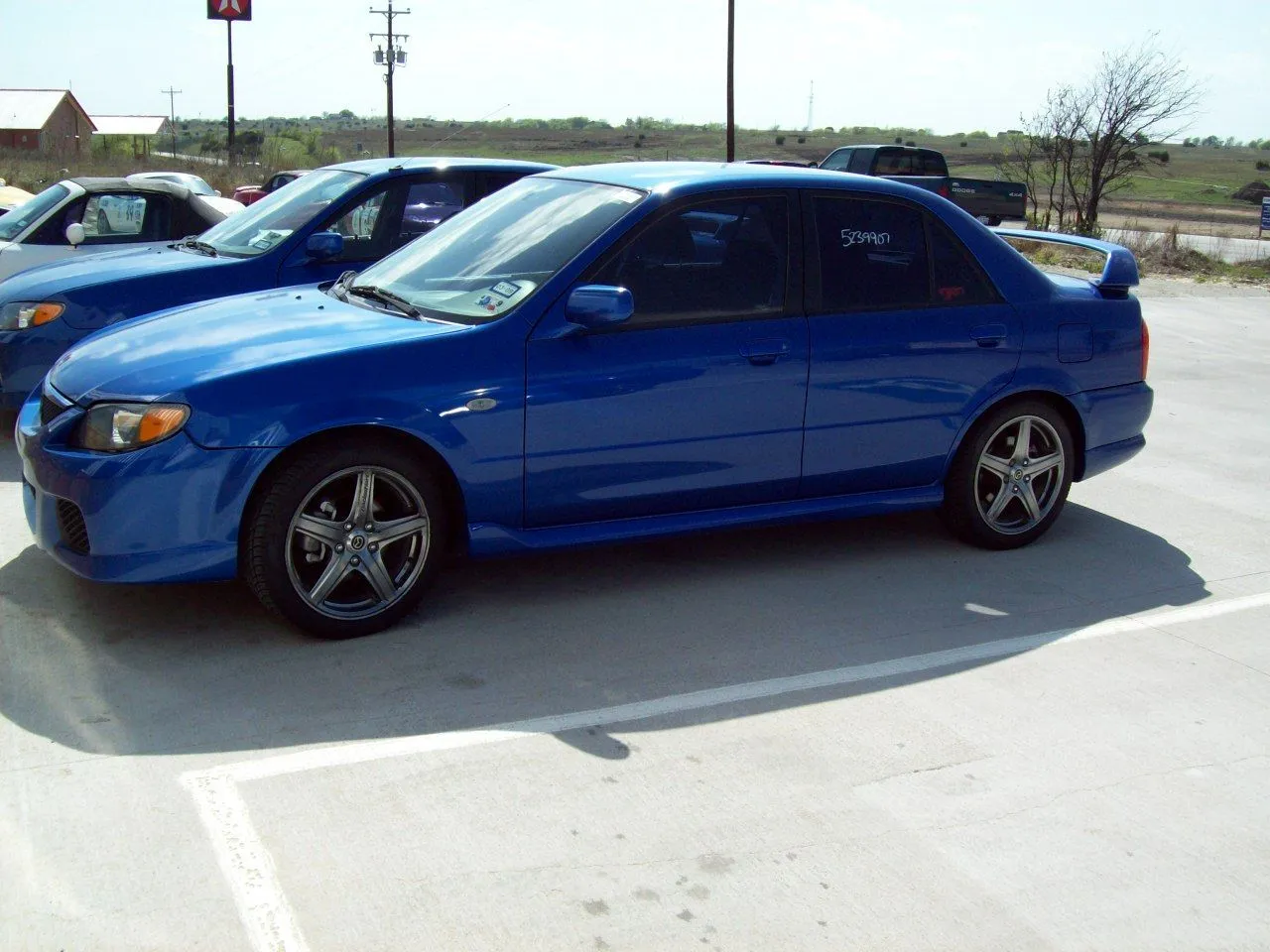

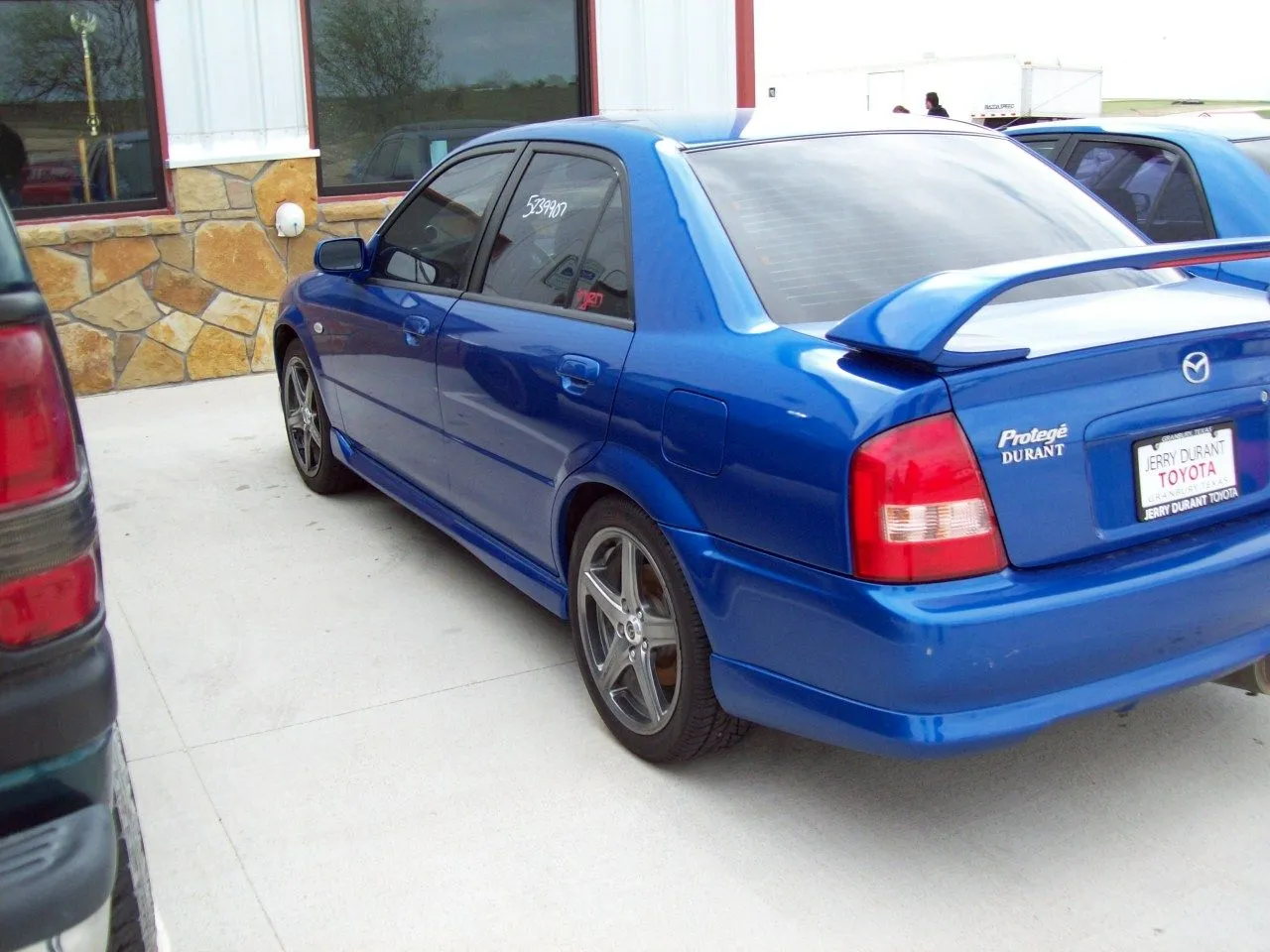

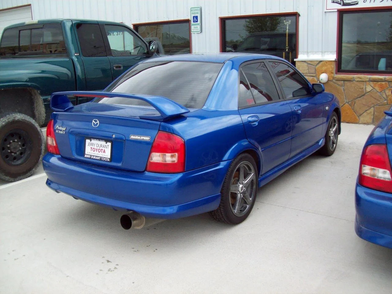

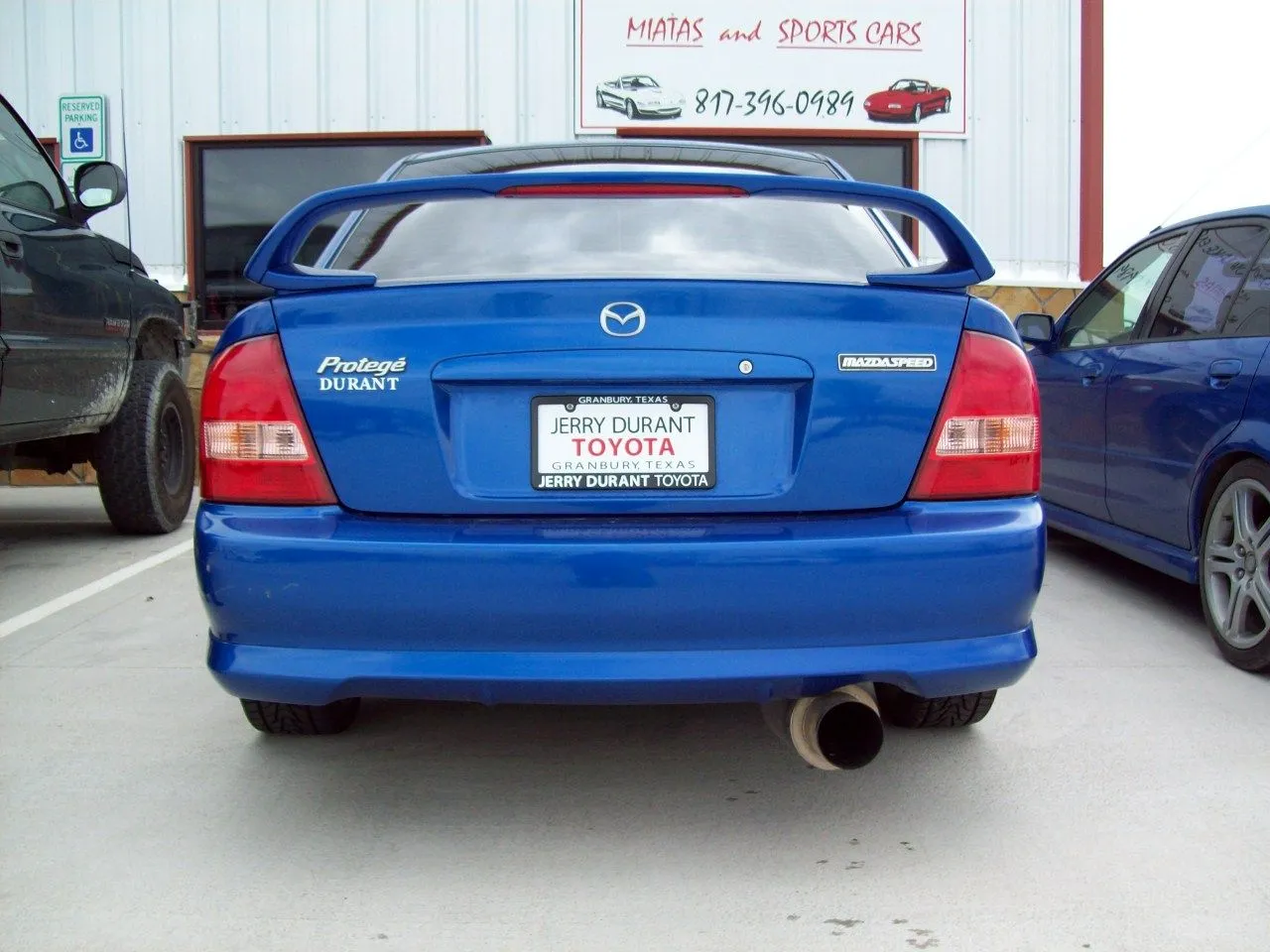

Well. finally got around to looking at it again. I cannot find any obvious frame damage. The radiator support was not pulled as I originally thought.
Body and paint are really good minus the bumper fit. Paint on the new hood is not as good. A few PDR-able dings and a scratch on the rear bumper.
I drove it around and it is terrible slow (and loud). Shifts fine. All original suspension pieces. A/C blows cold.
No MAF that I can see. One fan.
Fantastic interior. No smoke, no stains, no apparent wear.
This car is should be brought back. Will make a great car for someone who totalled theirs or wants to build something special.
I took a bunch more pictures. Here are a few.
