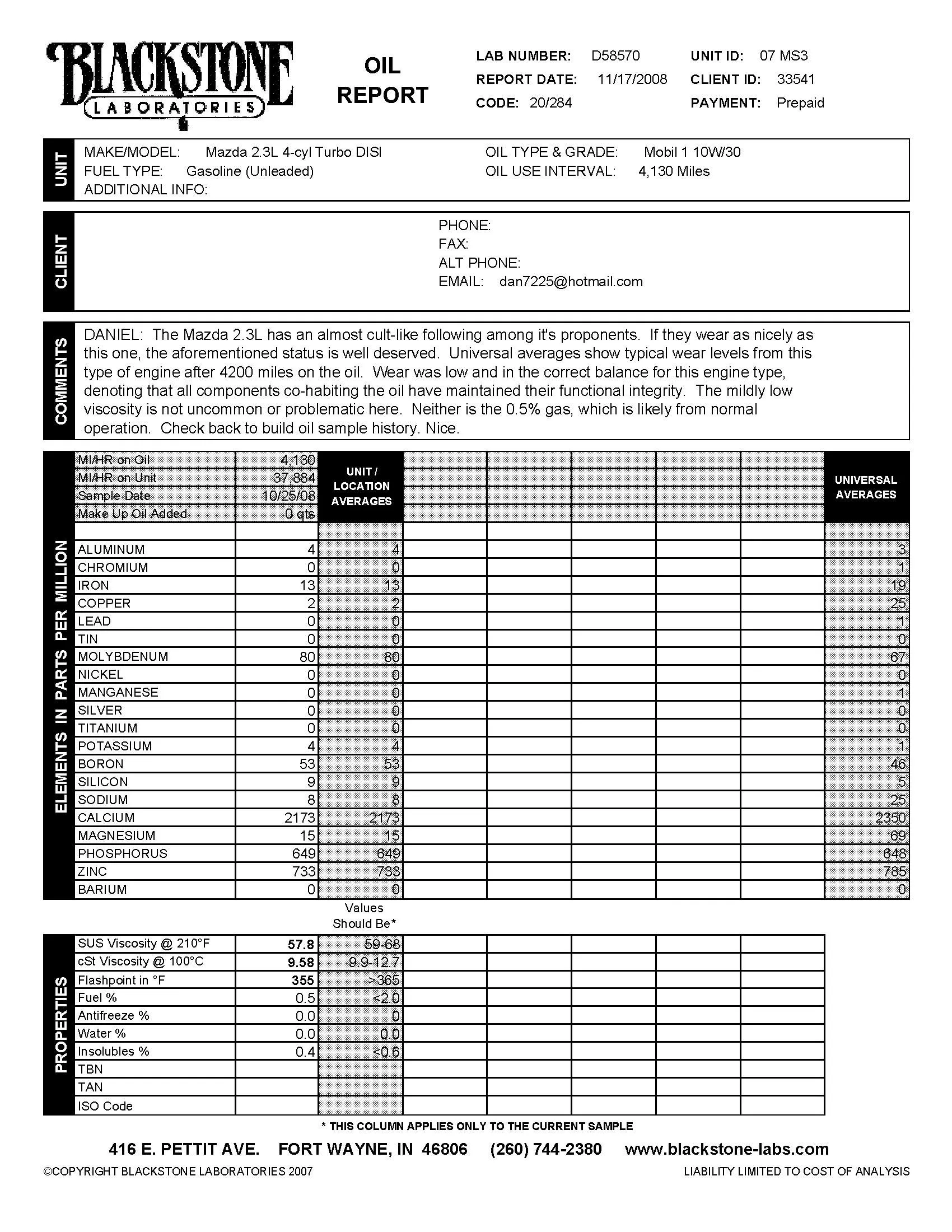

Here's my latest UOA from Blackstone:
Miles on engine 25109
Miles on oil 4989
Date sampled 10/06/08
Make Up Oil 0.0 qt.
OEM Mazda Filter
Mobil 1 5W-30
Aluminum 4
Chromium 1
Iron 27
Copper 5
Lead 0
Tin 1
Moly 97
Nickel 0
Manganese 0
Silver 0
Ti 0
Potassium 2
Boron 53
Silicon 7
Sodium 7
Calcium 2365
Magnesium 13
Phosphorus 627
Zinc 832
Barium 0
Sus Visc @ 210F 55.5 should be 55-62
cST Visc @ 100 C 8.92 should be 8.8-11.1
Flashpoint in F 385 should be >365
Fuel % <0.5 should be <2.0
Antifreeze 0.0
Water % 0.0 should be <0.1
Insolubles % 0.4 should be <0.6
TBN 3.4
__________________
Iron and copper have dropped with each subsequent UOA since my first check at 10000 miles.
more data for the folks who may still have doubt that you don't need to change your oil as often as 3-4K miles
