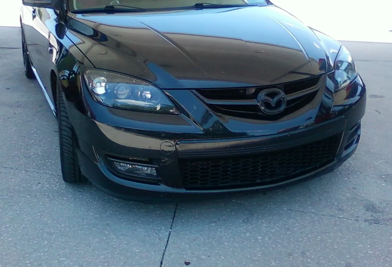

just wanted to put up beyyer pics of the headlights, the glare is tough to beat, and my new cell has a crap camera

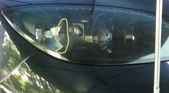

What I did was prep the chrome with scotchbrite and comet, just shot the low beam with satin all over, the turn and high trim rings got satin on the outside, and flat along the rippled ridge, but not the bowl itself. this preserves the light intensity, and still makes the chrome appear to black down. Applied these small areas with a qtip dipped in the same paint, just spray it into the cap, and let it set a minute
What I think I should do, ........someday.
is put a 18 inch white along the bottom of the shell as suggested (true, my bad) and put this 12 along the fog shell in the same pattern
then try to hook em into the DRL circuit instead of the HID, without causing the ECU to have a stroke

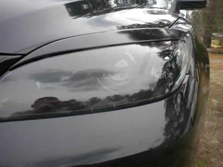

i still couldnt stand cant stand the chrome wish i could do this to the rears
oh but there is chrome tho on my chrome out turn signal bulbs looks bad i think
