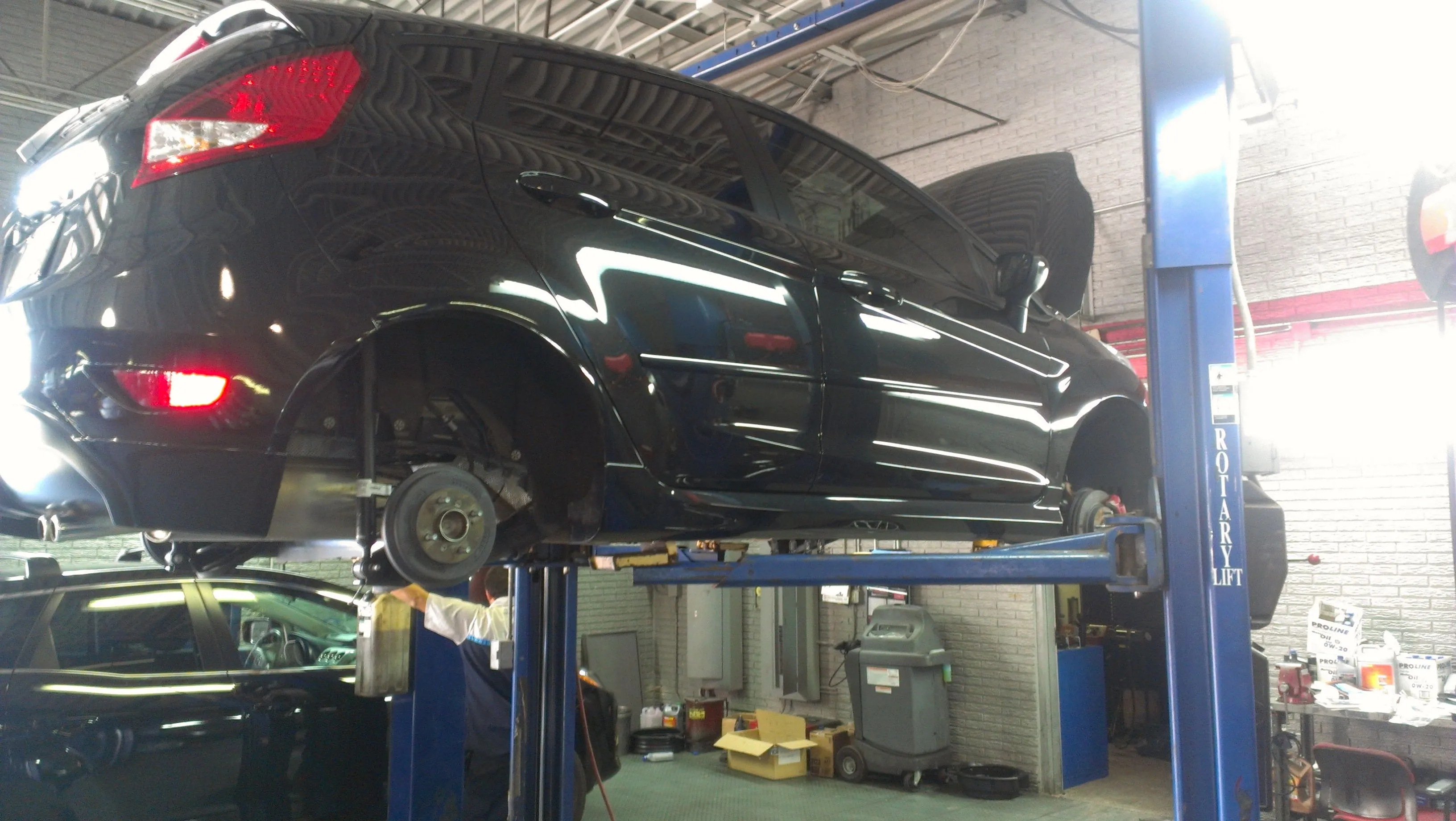

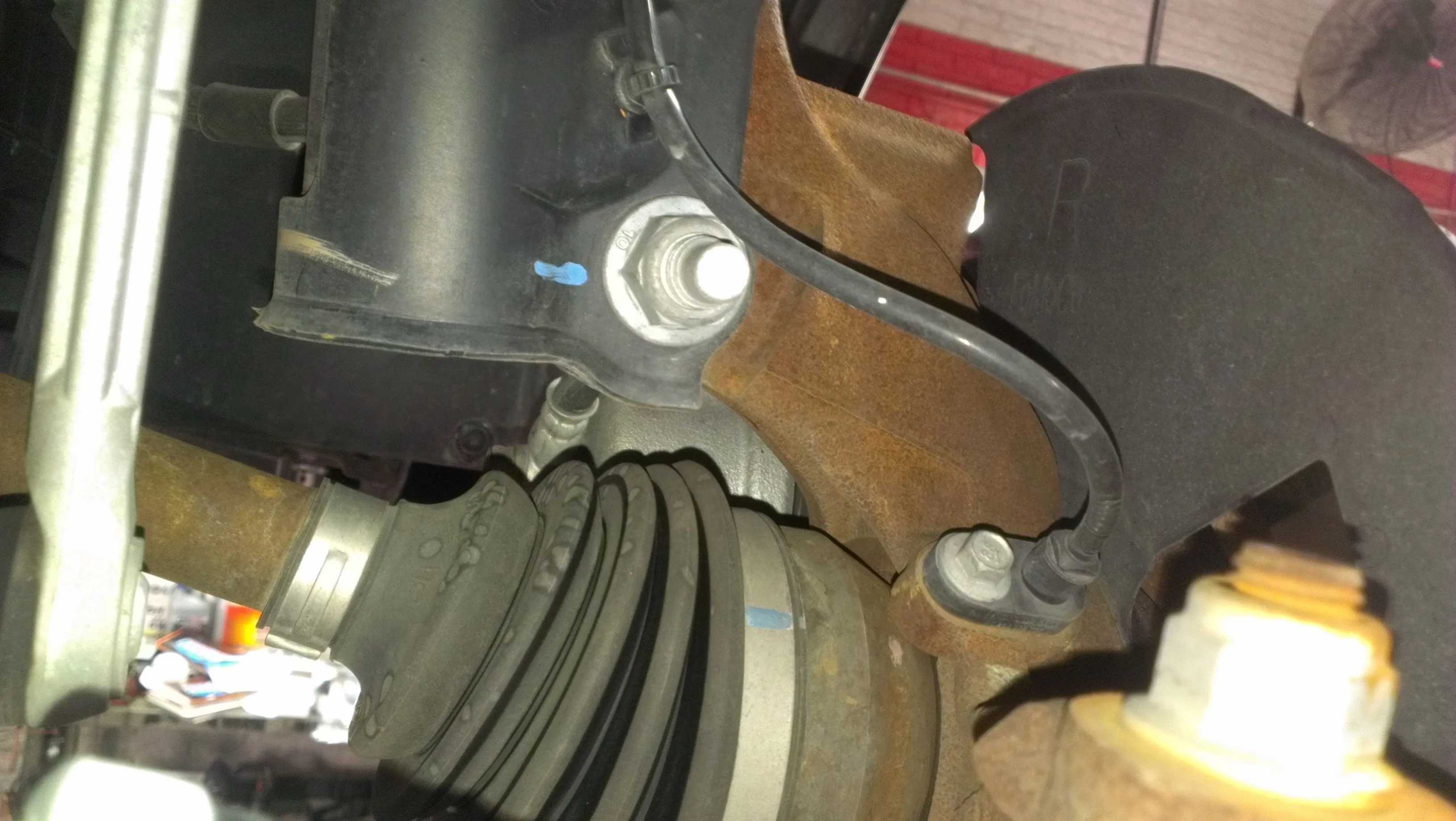

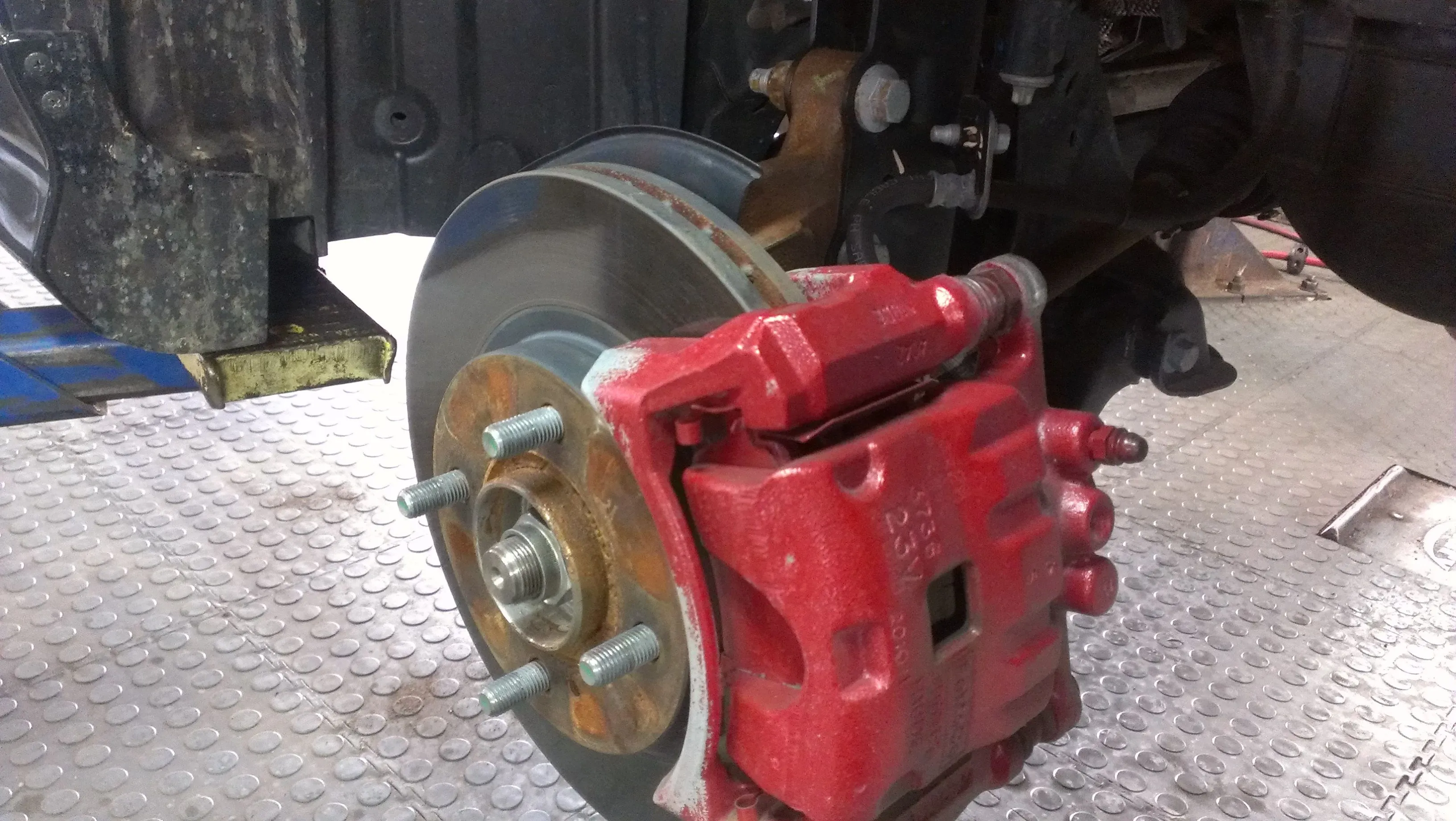

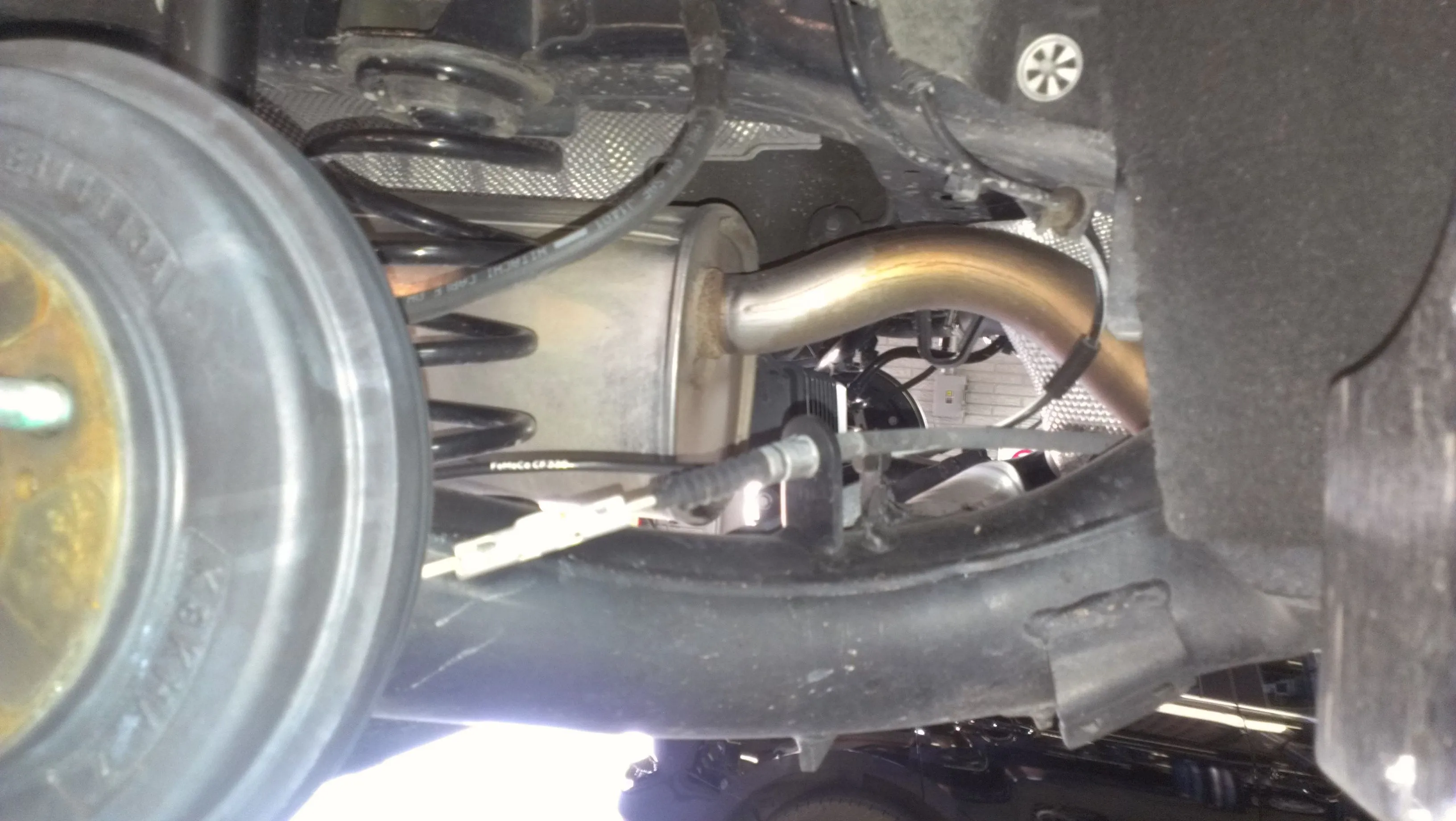

So far fronts work but have to use Honda hat for front and shim inbound side of hangar with two shims to compensate for offset approximate 1/8". This is not a problem because mounting bolts have plenty of thread engagement. Both knuckles on each car are the same, lines are same only difference are clip location. As for the rear both cars use same hub mounts and it should be cut and dry however fiesta offset is higher and the hat is the only problem. It needs a hat with a 8x7 bolt pattern to fit on willwood rotor and 1.18 offset Hondas does not work and neither does miata because their rotor is 9" and this kit 11 3/4. If we can't find a hat they can custom make one but I'm sure price is retarded unless large quantity was ordered. Unfortunately there is not enough material on fiesta hat to just redrill.

These are shots off fiesta in air for comparison.
We are still waiting on kit and while he will ultimately be using this one we are getting whatever else is needed for my car to test fit before he installs it.
If you would like to contribute to troubleshooting I have room for optimism only. Any help is welcome let me know if we are overlooking anything before this happens.
