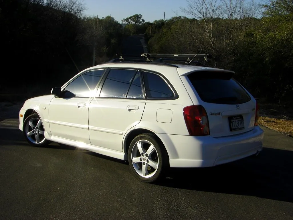

For reference, heres my 2003 p5, stock height, with 205-45z-r16 on 'er.
-Jason

Thanks mate. Not too shabby for 89k miles. Yup, definitly looking for a drop. I was thinking the eibach pros/tokico strut route others have had success with.
-jason
