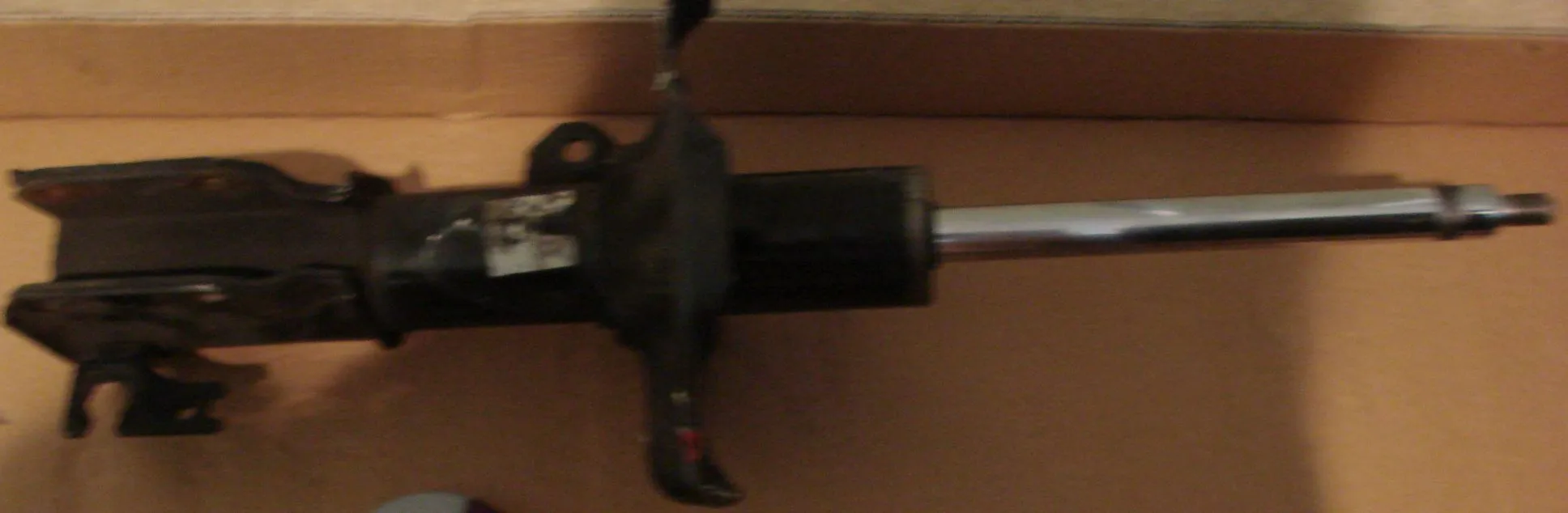

Not exact measurements but as close as I could get tonight with a tape measure on regular protege/5 struts.
Front 21 and 5/8"
Rear 26 and 1/8"
That is from the very bottom of the strut (lower than an insert will be able to get in there) to the tip of the shaft including the threaded portion.
Let me know if you need me to measure more or if you want some pictures of measurements.

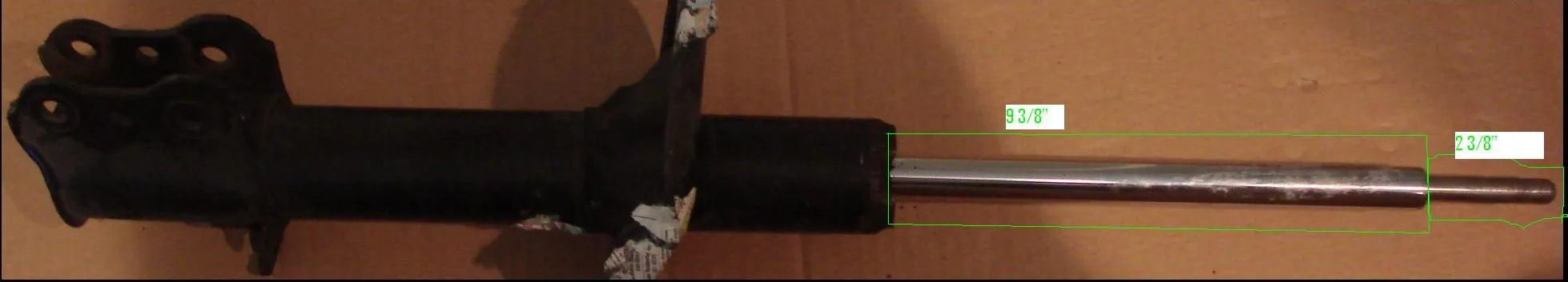

Seems a bit long in the rear. Any chance you could measure out how long the threaded sections are F and R since Gavin left that out of the equation? Guessing it's at most 1.5". Also did you measure from the base of the strut tube? So far it's not looking good for the rear with the inserts. If you could break it down to strut tube length and piston length that would be awesome. I should just pull out one strut from the front and rear and measure them, I just don't have the time to do it.
Shaft
Front 7 and 7/8"
Rear 9 and 3/8"

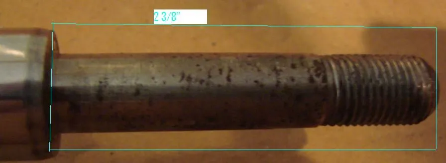

Threaded.
Front 7/8"
Rear 2 and 3/8" (I say threaded but it is not all threaded but it is past the smooth part of the shock shaft.) See attached photos for more details.
My measurements were from the bottom of the mounting bracket where it goes around the actual strut tube. It is a little lower than the actual tube where you would be able to mount the strut by at least 1/4" - 1/2" or more.

My initial measurements were from the bottom of the strut to the top of the threaded portion of the shaft (see more MS paint details attached)
If you subtract out the threaded part of the shaft on both of them you get.
Rear - 23 and 3/4"
Front - 20 and 3/4"
Rear - 23 and 3/4"
Front - 20 and 3/4"
Ack...Im a dumass. The struts I measured were complete units with springs so I couldnt actually measure to the bottom of the threaded portion.
That above sentence should have read that I measured from the bosttom of the struts to the top of the threaded portion of the strut shaft, not the unthreaded portion.
Sorry for the confusion

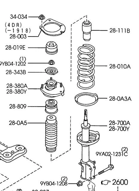

Also here is a picture of the strut and everything else from the mazda parts catalog for a P5. but I can't remember if the whole length of threading is used or not in the rear.
