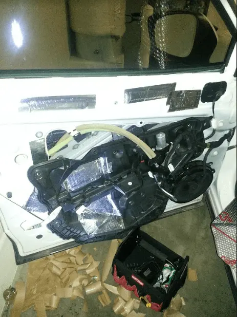

Preferably a sheet/s covering more than just that panel. Like this:
cache.php
Behind that MLV sheet you install CLD tiles like my attached pic from my project.
You also have, on the outer skin as well, right?
Outer skin = apply CLD (aka dynomat type products).
Inner skin = MLV.
To take it a step further add a decoupler (closed cell foam, ect.) on the inner skin then apply MLV on top of it.
