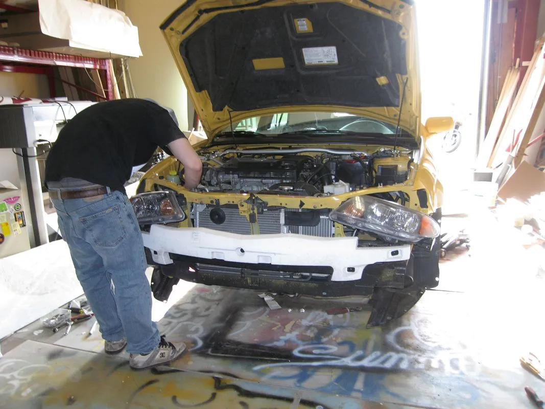

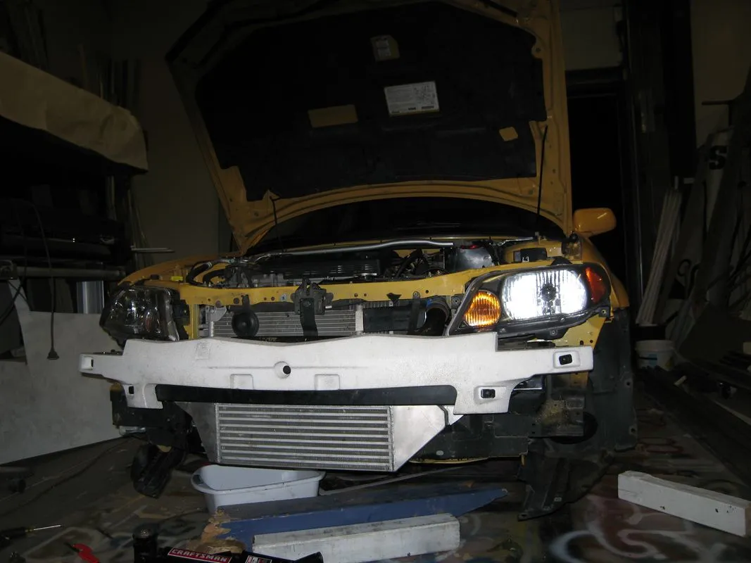

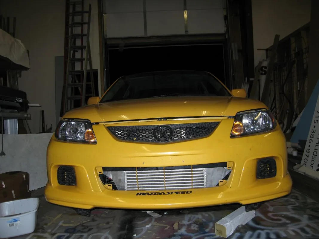

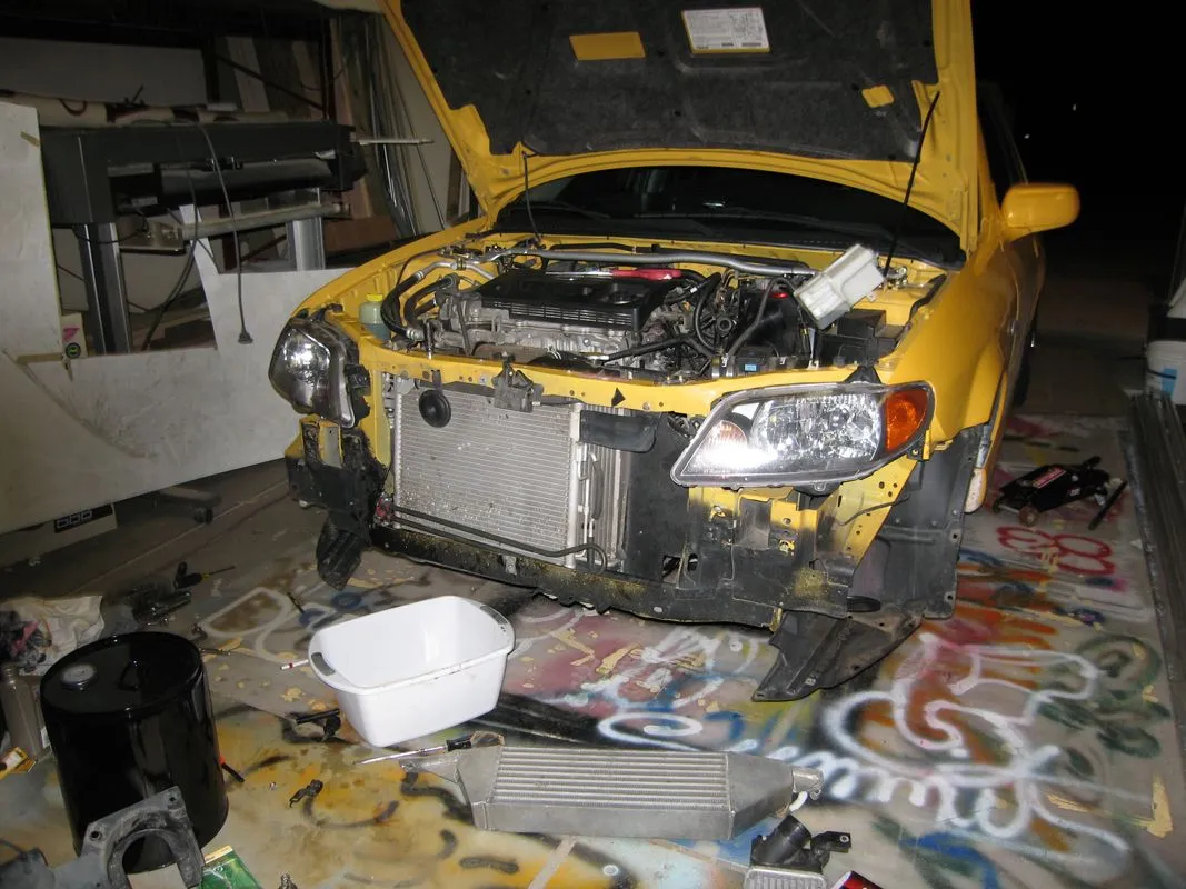

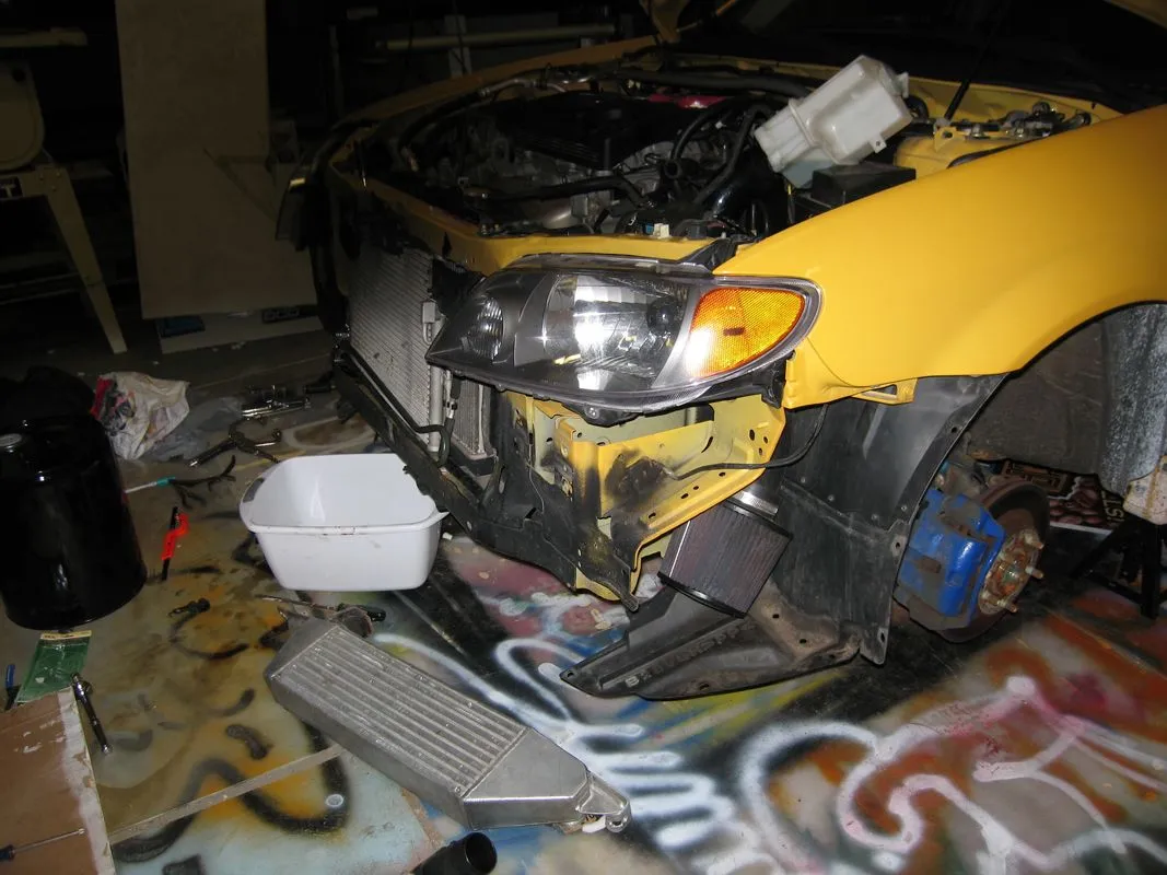

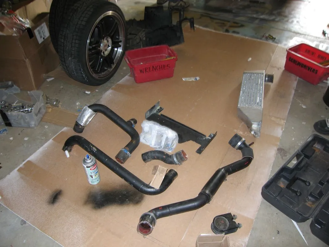

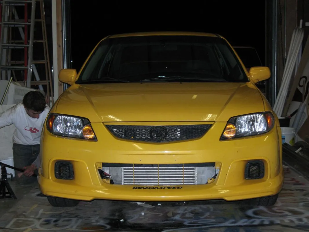

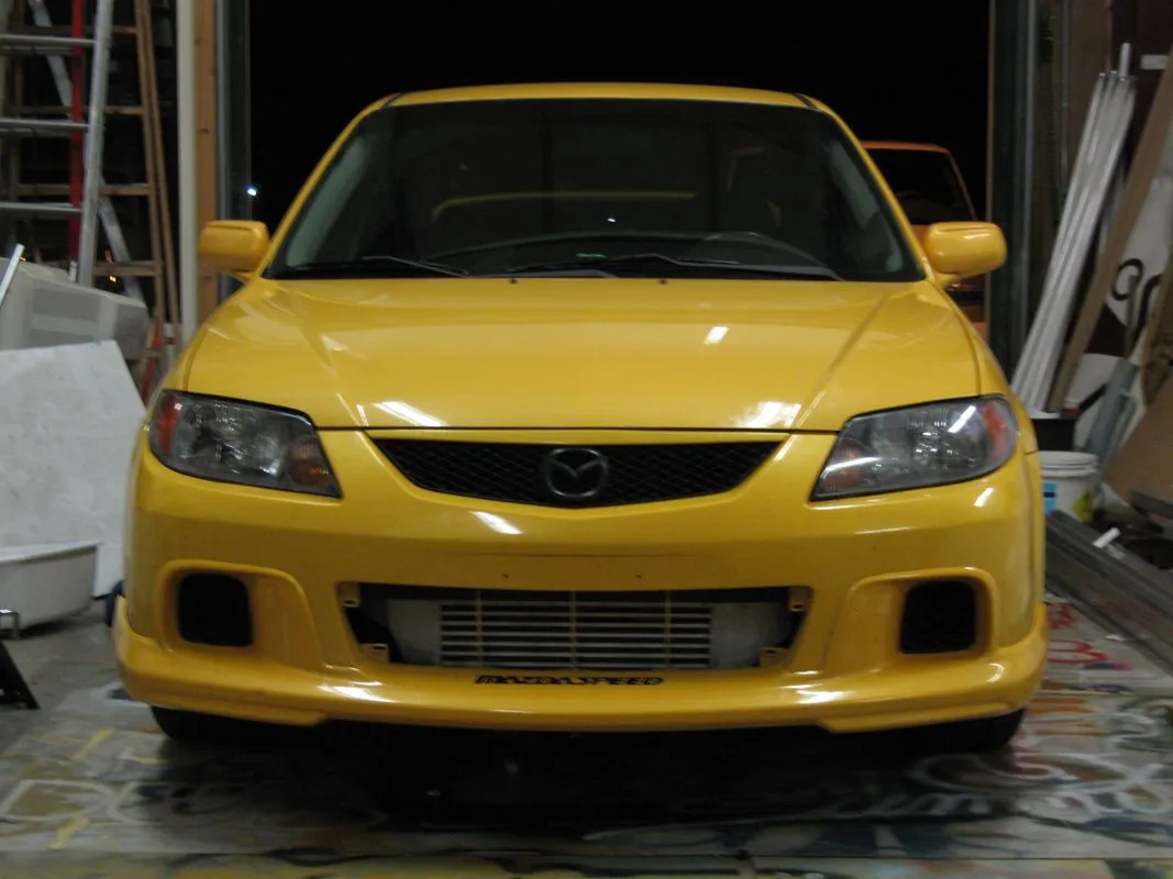

got the BEGi fri from another member, installed it sat. took about 7 hours full install. thought i'd post some pics, has anyone cut off those side brackets? any pics of what it looks like with that crap cut, Im tempted to but dont know cause I might want to put mesh back on.

plus after Installing, It quieted my turkey quite a bit! basically all low end turkey is gone, and i used to hear it on almost every shift! only heard if i rev it out past 4.5k now. tell me if more people cant see the pics people, i'll re upload them smaller.
there. that should work, Im on a mac, sometime uploading pics on html just dont work for a pc to see

-sandspeed. did you cut those brackets that hold the mesh in? I didn't notice them when I looked at yours. but it was a while ago.

nope , I still have the lower mesh grill. I prefer to keep the front mount somewhat hidden from debri.

Wow, looks good. Still trying to decide what FMIC to go with. Its either this or Perrin....
Looking awesome, I agree with sandsped though. Put the mesh in there and keep debri from hitting your intercooler. It may look cooler without, but in a year when its all pitted from larger rocks, you'll wish the mesh had been there.
