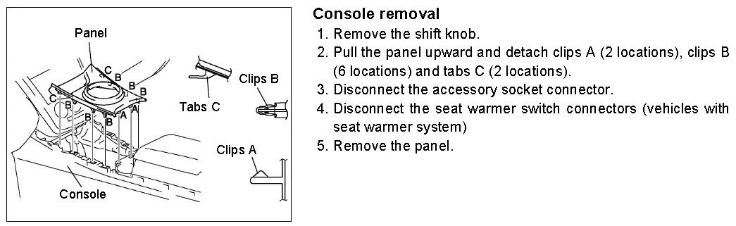

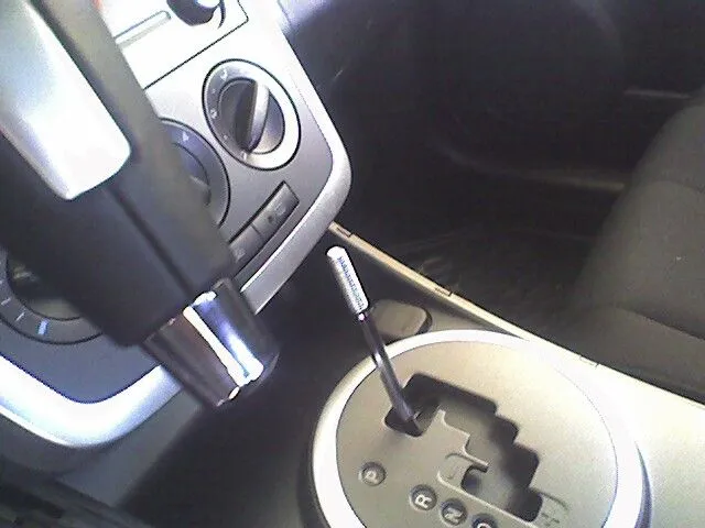

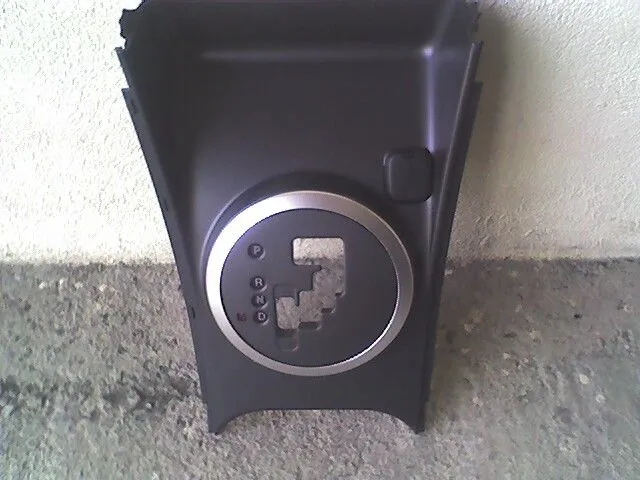

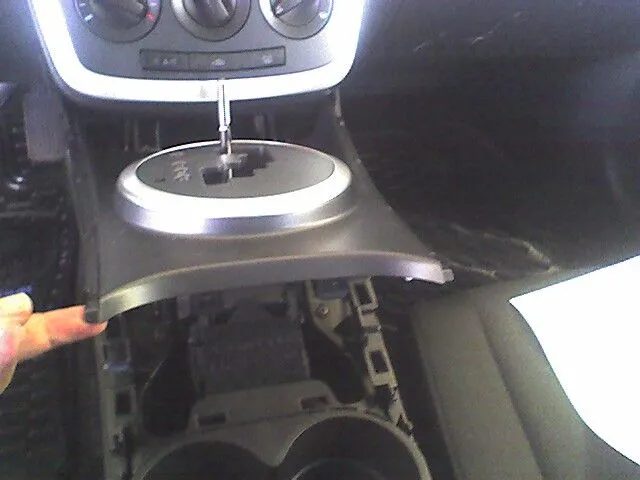

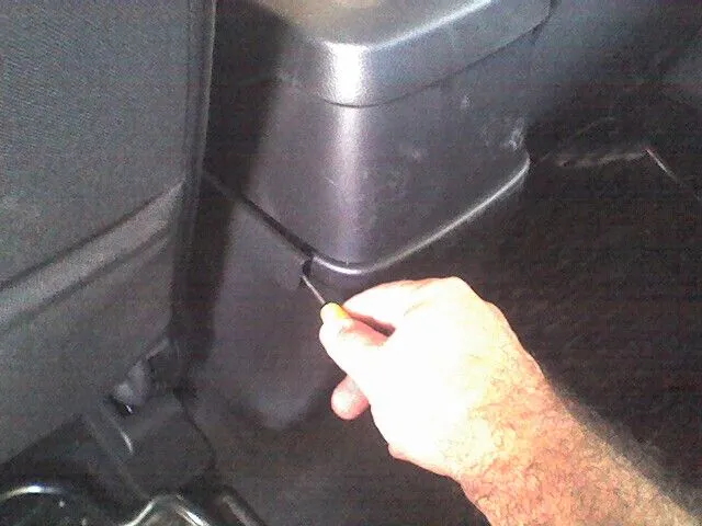

Then, I removed the panel under the shift handle. First remove the shift knob counterclock wise, then lift up the panel. This part is easy.

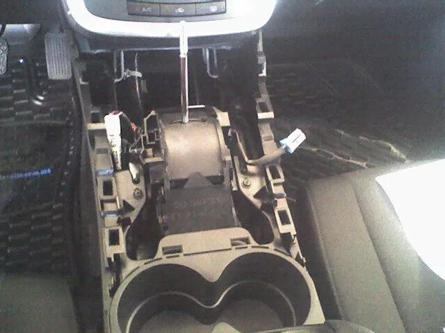

This is how the panel look up to this point.

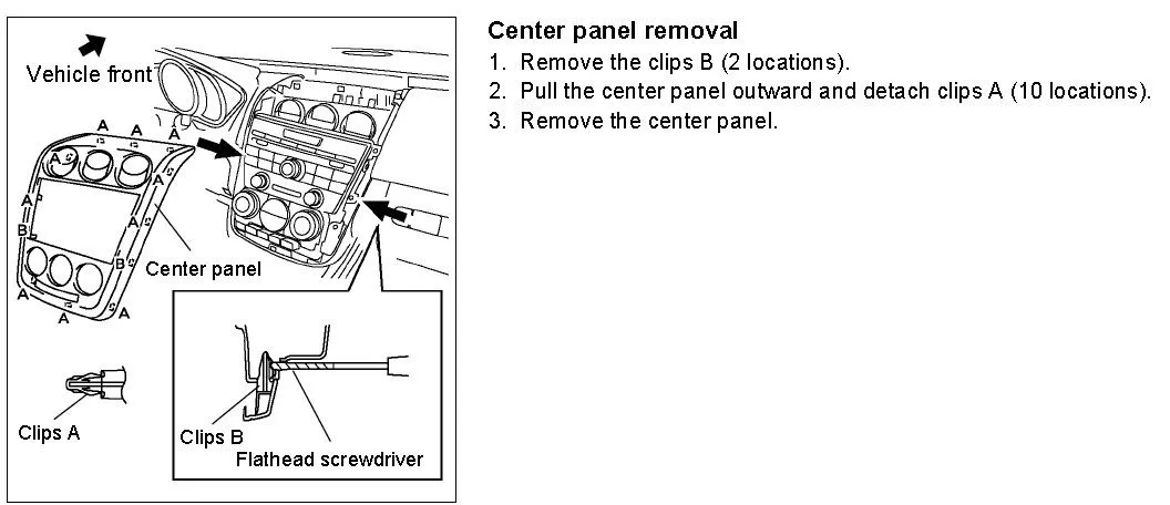

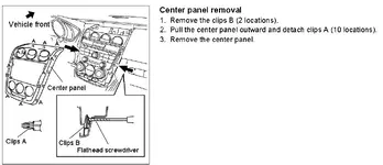

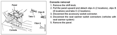

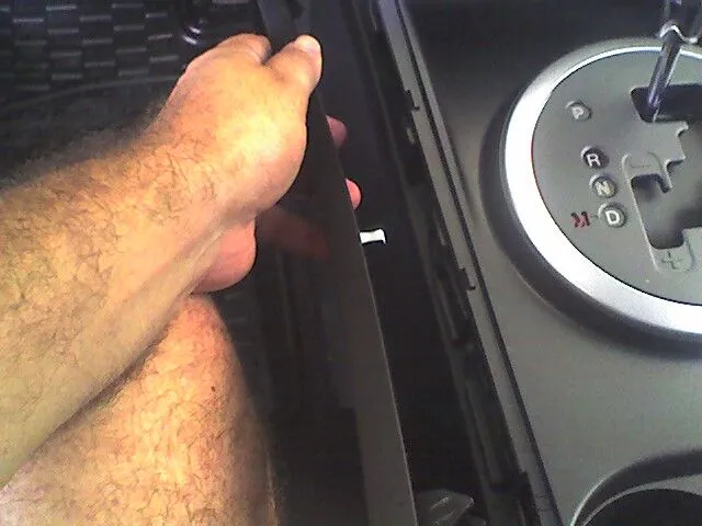

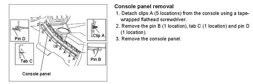

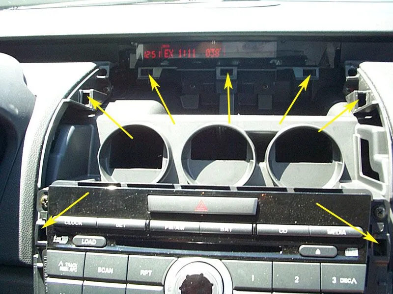

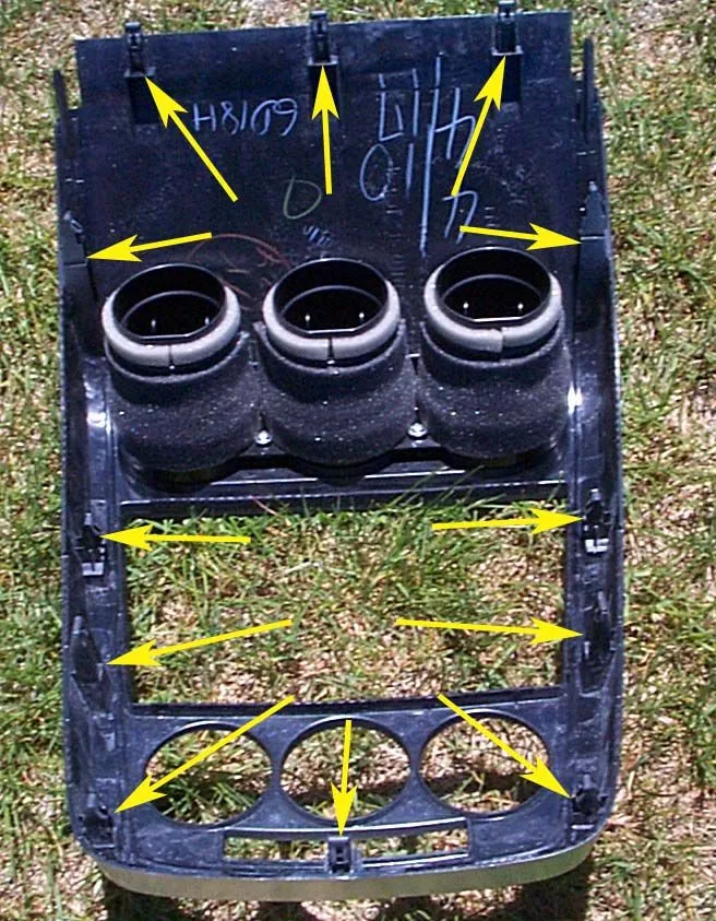

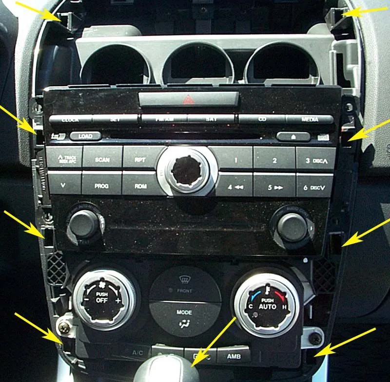

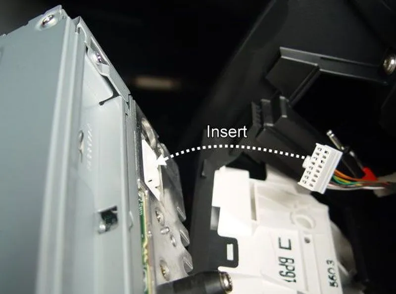

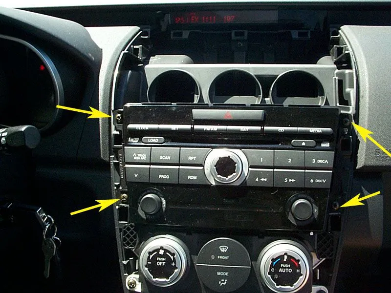

Then you should follow the removal of the central panel. I didn't include any photos, as skeppley did it very well. I do include a diagram of the removal.

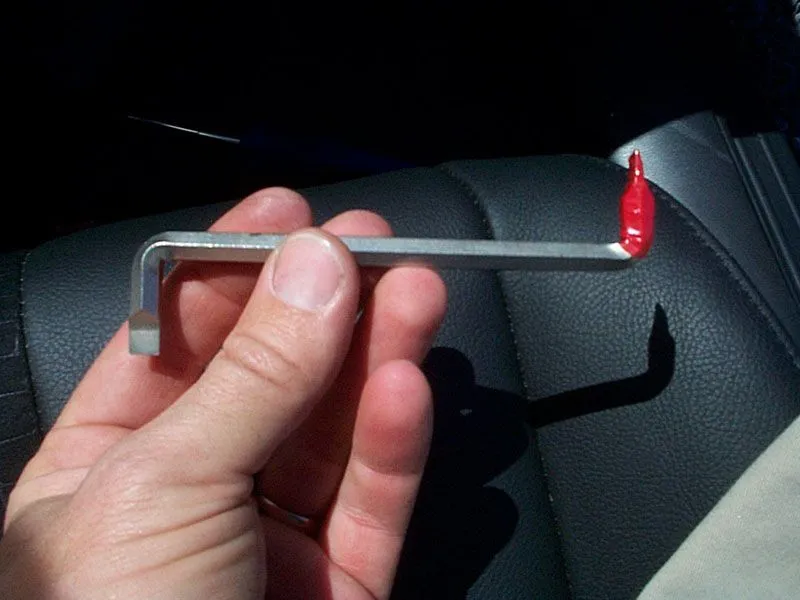

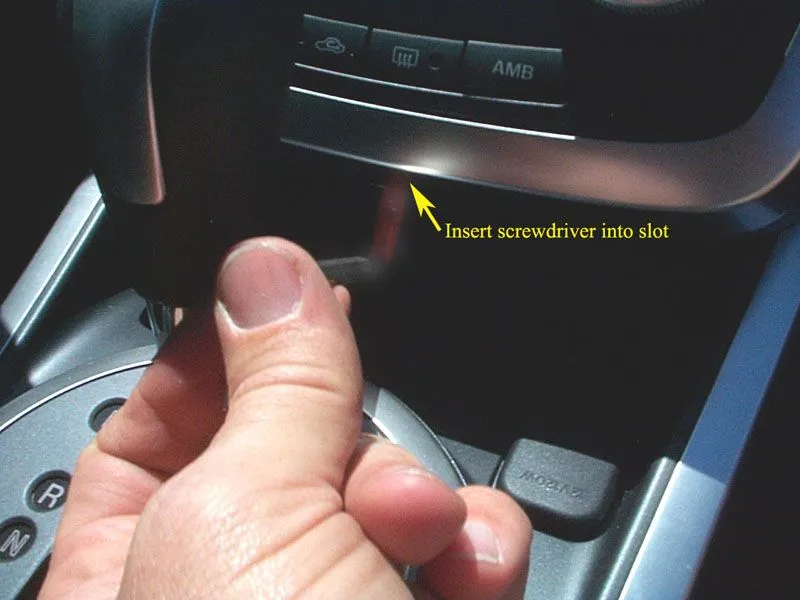

The diagram suggest beginning with the 2 "B clips". I did as skeppley, which, if you remove the shift panel posted before, you don't need a two bend screwdriver. A plain one will do. However, the 2 "B clips" are very different of the "A clips", being the former metal ones.

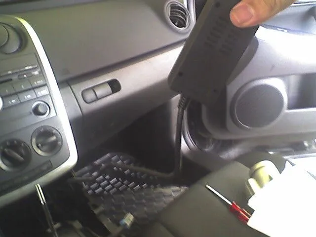

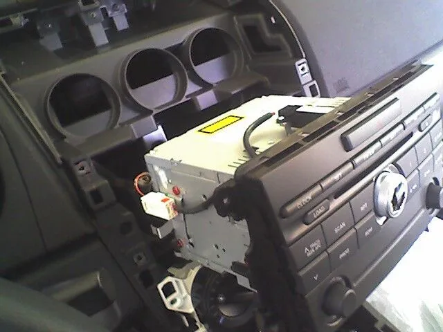

The removal of the central panel was the most delicate step. The remove the stereo, plug the Audio link, run the audiolink to the bottom and then you are all set.

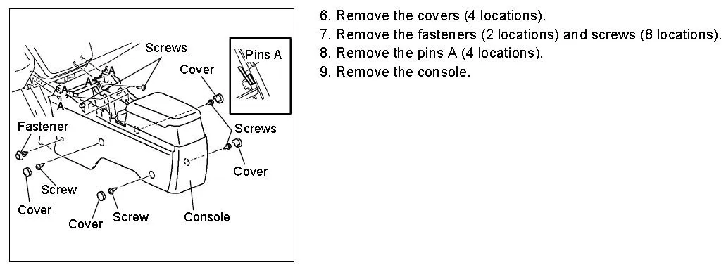

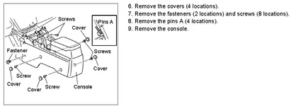

Then you remove the central console, basically unscrewing eight screws and removing two fasteners (my only mistake was breaking one of the two plastic fasteners; it should be an easy repair; my problem was that I didn't new the nature of those fasteners). I have to say that two of the screws, the ones under the stereo rack, are hex heads and you need a long hex screwdriver, and I was lucky that matched the only one I have.

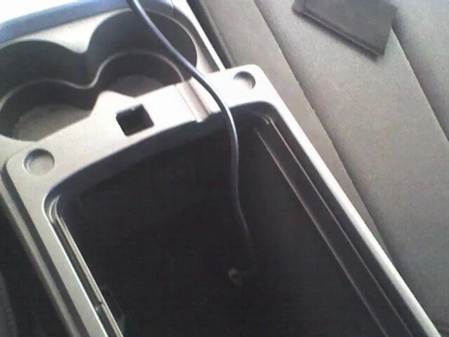

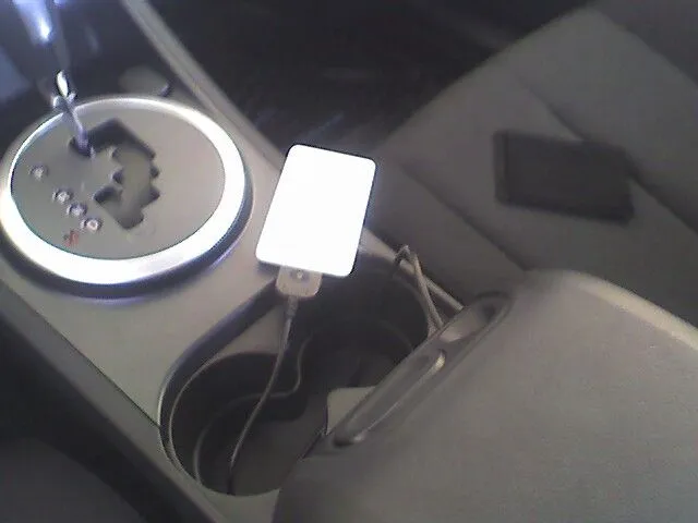

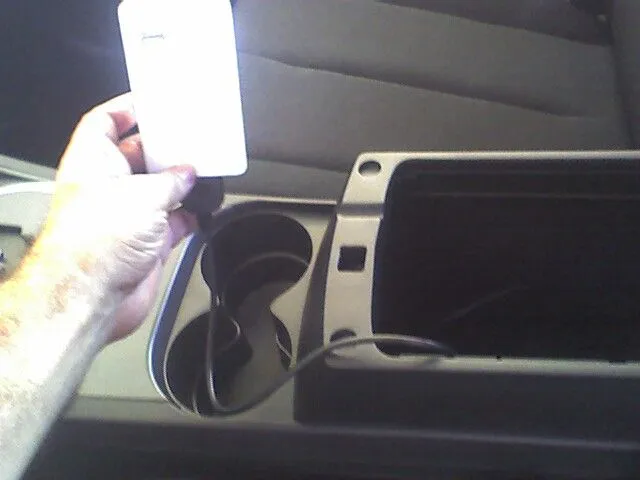

I drilled a hole in the central armrest, from where a run the audio link / ipod cable. Then, you can run it outside the console, or leave the ipod inside. The beauty is that you can lock the ipod inside. The ipod starts and shuts down automatically when you turn off the car.
Back to the installation: Going back to my experience, It might be possible, but I am not sure, that you can skip the removal of the central console and still do the installation. Maybe if you "guide" the ipod cable once you drill the hole, you can do it. As I say, I am not sure.
I did not remove completely the central console. You can say that I just moved it around to see the bottom, to search for best drill location, and to make sure I wouldn't screw up anything.
Everything went as planned, and there is a certain relief once you place everything in its place. Hope this would help.

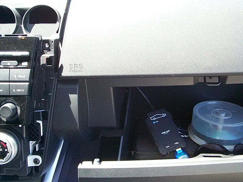

Just got mine today, and tore into the dash when I got home to install it.
Has anyone else gotten a buzzing sound out of this thing when it's connected and active through the head unit? I ran the connector wire from under the dash next to the driver's right knee (thinking I might attach it to that side panel so it's conveniently located), then tried the other footwell in case the buzz was caused by interference from something under the driver-side dash. I'm getting the buzz from both sides.

I mounted the device with Velcro next to my right knee. A neat touch is that, when the device is on/active, a blue light glows, not unlike the overhead blue light, illuminating the driver's footwell.
And, BTW, I found removing the center bezel less than easy. Worth it, yes, but easy, no.

I also had problems with the "B" clips on the factory face-plate cover. Apparently these clips need to be "uncliped" with a screw-driver. They will not let go without bending. Both my "B" clips got bent, I removed them completely. Everything fit snug -no issues.
