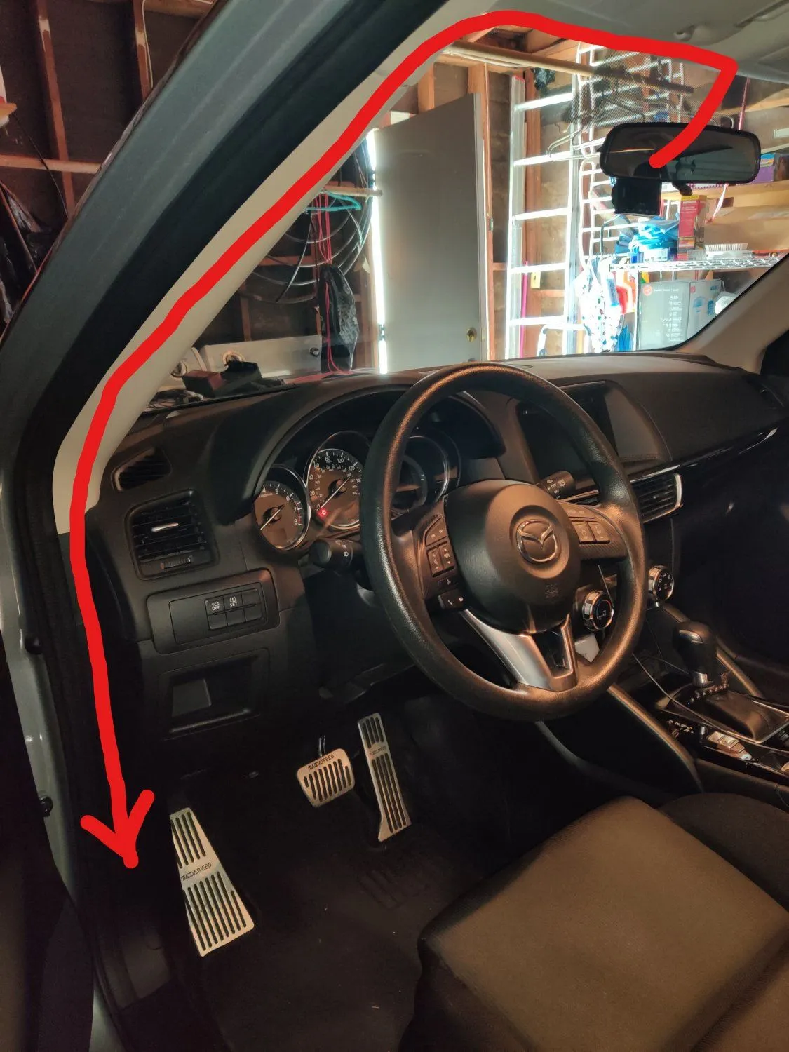

I have been hardwired the dashcam to my inside fuse box for a year, but problems came up and now I am rethinking the way I do the hardwiring.

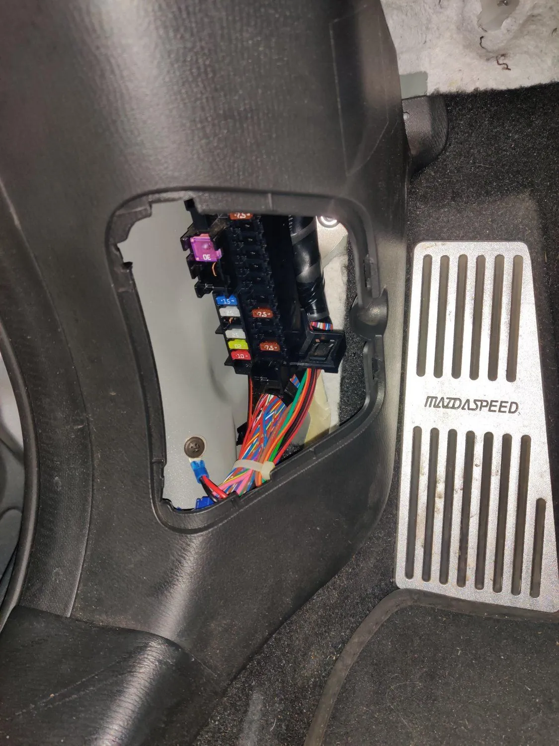

How I hardwire: wire pass through the driver side A pillar and goes down to the fuse box, there I use a fuse slot that is not assigned but powered all the time, and have the ground wire touch the screw as shown near the fuse box.

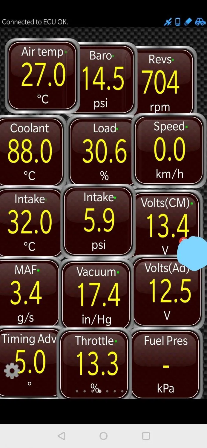

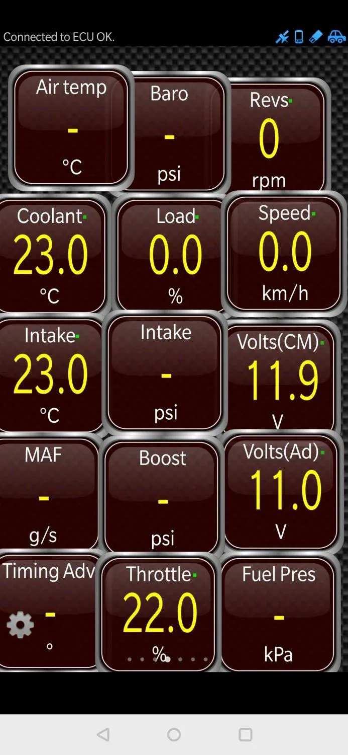

Also attached some operating/sitting voltages if that helps.

Interesting.... did you wire the the hot side of the unused fuse, or the other side and added a fuse? Have you tried pulling the fuse where you've hardwired to see if the remote distance and/or battery drain changes?

You need to move your fuse tap which has a fuse for the new and old circuit to one that is powered with the car running, like wipers or the one to the lighter plug you do not have...
