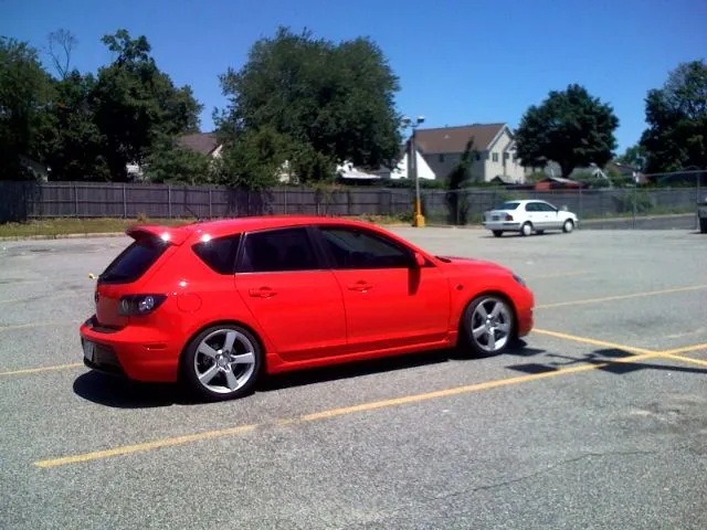

Great help had mine installed Monday LOVE them
Your car is fly...and is exaclty how mines gonna look cuz im getin those asap! So what do you think about them so far?
Thanks ! I love them the car is set up so much nicer now, and turns even more hed's. Always nice when a cute chick in her man's G35 is stretching her neck to check out YOUR car lol. Anyway tha car rides Great and its well worth the money.

H&R kit has ben back ordered FOREVER I looked at the kit as well i think its around $1100. While its opinion at best I enjoy the Mazdaspeed version so far. Sets up the care quite nice and alows a great agressive look or acompletely stock look.
NO! no rubbing at all, drop is 1.25 in front and between 1 and 1.25 in rear depending on how much gas is in the tank. Rockin the RX-8's yes !
