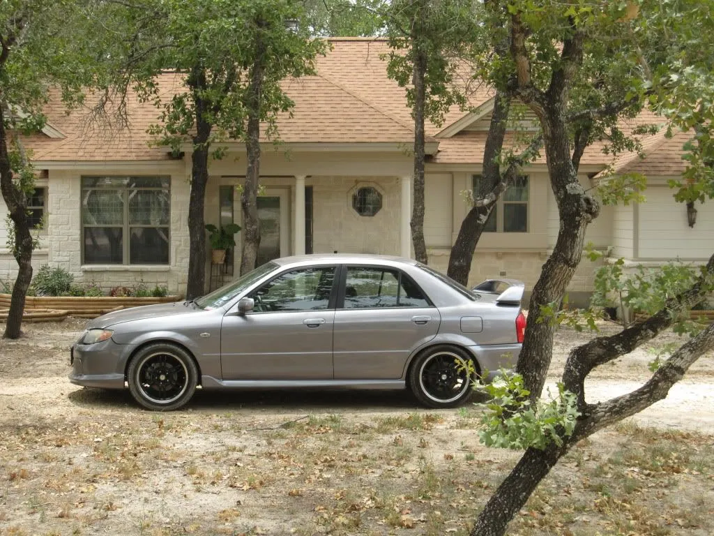

don't know specs, msp is built boosting 14 pounds
Wow, I wouldn't think it would be that obvious. Although, it looks like he has the same aspect ratio on both which would put a larger diameter on the front.
I think ideally you would want an 8.5" wheel with a 245/40-17 tire on the front so tire diameter would be nearly identical. Keep the back stock on a 7.5" 215/45-17 and find a +45 offset to bring the wheels out 10mm. On the front, the extra inch should bring out the wheel out 12.5, but you'd probably need to bring it 10mm as well to keep from rubbing the wheel well on full lock turns. With an extra 22.5mm, it's probably past the fender at that point.
