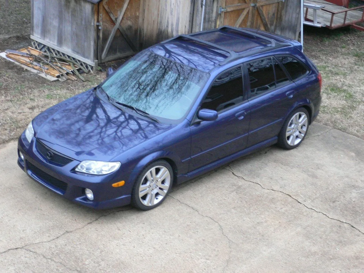

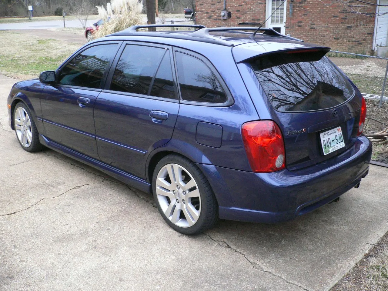

Well, it's been a month and a half since I started this. I am bored and thought I would post a couple of pics. I know some people wanted this thread to die, but some people wanted to see the pics. It turned out exactly like I wanted. By the way, I ordered new wheels, so if anyone would be interested in these, PM me. Also forgot to mention how great it handles with new struts/springs/sway bars. Huge difference.
Well the problem now is I am putting a sub in the back. If it goes any lower I will cut a half a coil off the front or just ditch that rubber seat under the front coil. It's only one 12", so hopefully it will be okay.
