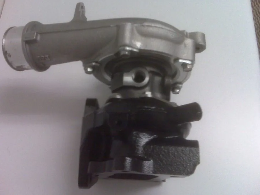

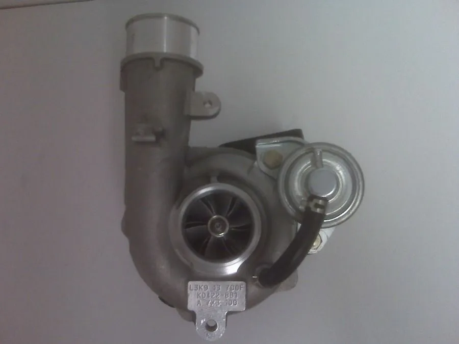

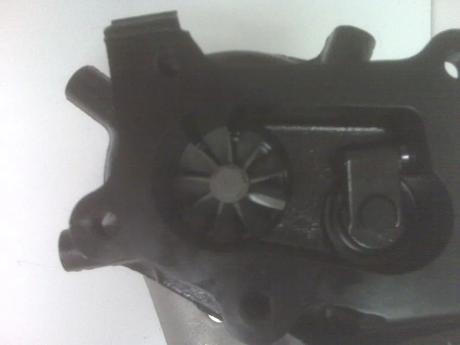

Any one look at this turbo kit
I don't know if you will be happy with the ball bearing turbos. Since the 7 is automatic, you need a smaller turbine housing for response. Either that or you will need a higher stall converter with the bigger turbo. Have you seen this K04/Garrett hybrid upgrade for the CX7?
