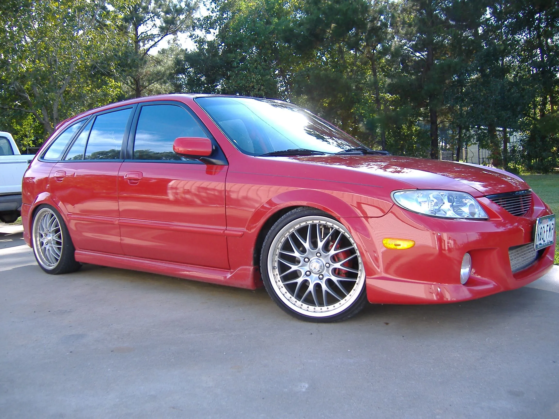

Well, for your reference, I'm running 185 width tire on a 6" rim with +41 offset (winter setup). That combo leaves very little room in the back for the tires to travel past the fender.
Yes! You have the sizes and offsets right in your first post. I have 7.5 50mm offset with about .200" to the coilovers and .200" to the fender.

No problem man...wish I had the answers you wanted but it's very tight back there! I've tested the limits!
