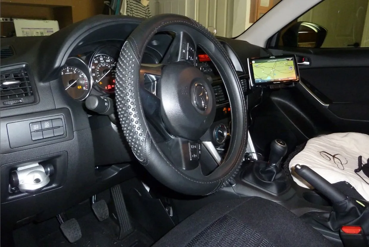

Not wanting to pay big bucks for the NAV package, ...... since I only use a GPS for road trips.... this (see pic) was my solution... That GPS is a Magellan model 1700 (big screen for my old eyes... ) That model GPS also has a video input, if the passenger wanted to view a DVD, for example.

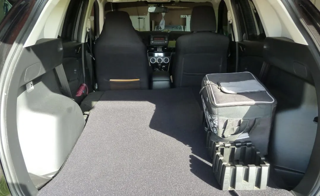

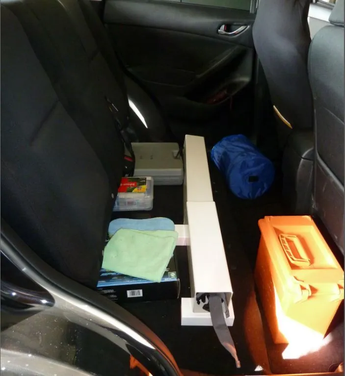

Since all the kids have moved out, I don't have passengers in the rear,.... and I wanted the fold down seats to lay flat.... this was my solution (see pics )-- this also gives you some storage area for various things. I had some PVC fence pieces laying around, and I used those to hold up the rear seats (when lowered down) to give a flat back area. The rear seat comes out, by removing four bolts..... the bolts are located under some removable trim pieces. I also acquired some carpet, to lay in the back area.... to protect the "factory carpet".
Also.... I couldn't figure out what that small storage pocket was for, ....to the left of the steering wheel, .... so... I put a LED "head-lamp" in the hole..... now it lights up the area near the fuse panel....
Seat covers: I found, on Amazon, a very good deal on some seat covers ($20 for two ), and by adding the steering wheel cover, ($6), I got the "super-saver free shipping". ( over $25 purchase, on Amazon, you often get free shipping ) --- see pics
