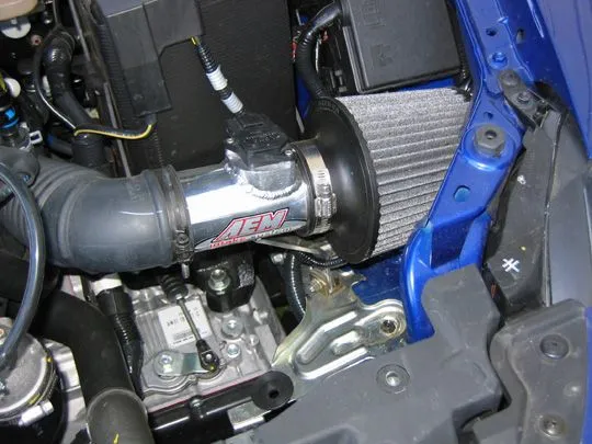

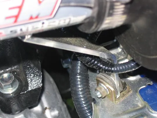

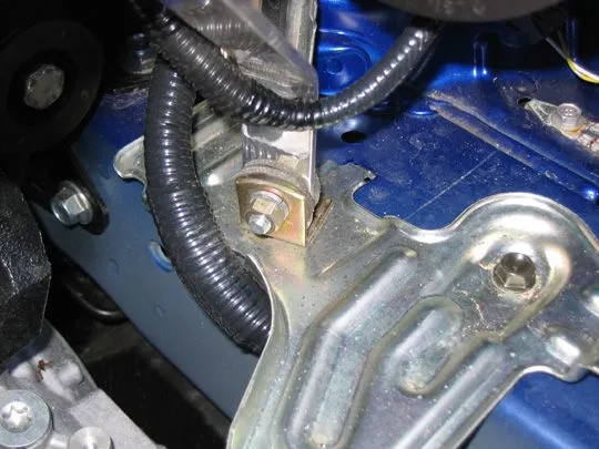

The intake bolts right on. You just need a 1 inch "L" bracket so you can bolt the intake tube to a frame rail bolt. I'm using the TurboXS hybrid BOV designed for the Mazdaspeed engine. Direct fit. Order direct from TurboXS. The intake makes a night and day difference. The amount of torque and hp gain is so worth the extra intake noise. Of course all the sucking noise can be considered a plus by some. Be prepared to explain the sucking noise to non-car enthusiasts though. Turbo make a lot of induction noise.

Here are install pics with the "L" bracket

The filter is held on by a hose clamp. Enough install questions. The whole install (removing the stock airbox, opening the AEM packaging, and installing the AEM intake) took 12 minutes. It is EASY. The only part of the intake that I did not remove was the lower resonator box. It requires left front wheel removal and comes out through the wheelwell. I purposely left it so that I could very quickly re-install the stock airbox if I needed (like going to the delaer).
