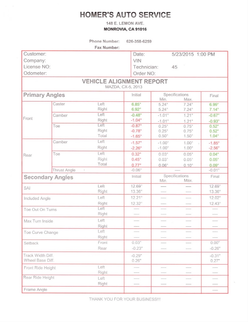

I will have to make the camber arms as well. I had higher hopes with these arms, but it seems like they did not help as much.
Here it is the before and after values.
attachment.php
Something doesn't seem right with these numbers. Let's dissect this some-
1. The right side caster and both front cambers changed from before to afters (initial to final). I don't see how this is possible when (1) caster and front camber aren't adjustable. Adjusting toe shouldn't have affected those angles that much at all.
2. Your front total toe was -1.65 out?! That's A LOT of negative toe from a (give or take) 2" inch drop . Enough to show feathering of the inside tire edges within a couple days if that # is true. Rub your hands on the inside edges of your front tires to feel any scuffing or feathering
3. Your rear camber got worse, and the rear toe wasn't nearly as out as the front. With basically the same drop as the front. You said the toe eccentric was maxed out all the way towards the center of the car, yet it only moved -0.28 and -0.40, respectively? That's not a lot of movement at all from the size of that eccentric.
What doesn't add up to me is that, with the toe eccentric is all the way towards the center of the car means the toe would go really negative and camber possibly slightly positive (it's tilting the back of the wheel in[- toe], pulling bottom of wheel slightly in[+ camber]). Then your modified arm's threaded adjusters should have been shortened, tilting the front of the wheel in [+ toe], which would cancel out the negative toe the back adjuster created, all while also pulling the bottom of wheel in [+ camber] Yet, the opposite happened. Camber got more negative while toe barely moved. (dunno). Are you sure the technician knew you had made adjustable arms and they needed to be adjusted? Most times they just read the factory instructions on the computer screen, and those instructions would not have included any camber adjustment. Sorry to hear it didn't work.
I will go back and ask him about this, because I feel like he did not do, what I have asked for.
I would have thought myself, that those camber number should have decreased, not the other way around.
Actually, I have 3-1/4" drop.
I will see, what they will say about this. If they can correct something from those numbers, then it's great, but if they can't, I think I figured it out, how I will make the factory camber arms adjustable.
Same as the toe arms. Cut out a piece, make room for those nuts(cut out with a mill, a piece from the center of the arm) weld them in and use the same method as with the other arms. Left and right nuts and adjuster.

^^^ Well, with all things considered, for a 3 1/4" drop that camber is still quite good. I believe some members have worse camber readings with stock springs. But yes, you can probably get even more if done correctly. Keep us posted.

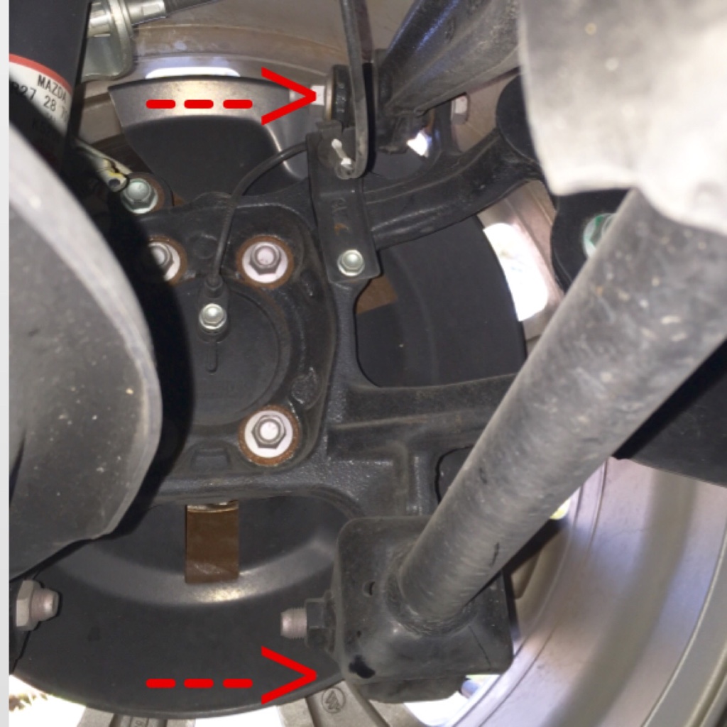

I cannot speak of the company in question's part, but I'm willing to bet that a part like that will allow for some camber adjustment, assuming it is made for 2013 up Mazda CX-5s. The reason I feel it will work is due to the position and angle of the arm in relation to the hub spindle. Using the factory toe eccentric rotated inwards towards the center of the car, in conjunction with shortening this rod will give the wheel more positive camber. Of course, the toe angle will have to be compensated to match, so how much positive camber produced I cannot say.

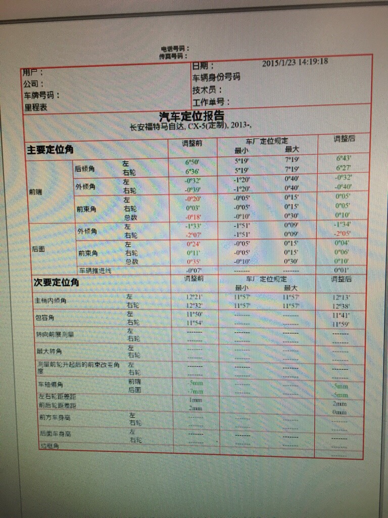

You data is very close to mine.
I am curious that the why the right side is worse.

I see a vast difference between the USA vs CHINA specs in front toe specifications. For USA CX-5s, the front toe median specs are +0.50(!) per side, while the CHINA CX-5s, it's a more normal +0.05 per side. I can only guess the excessive + toe is for more high speed stability on US roads? I'm surprised there are no complaints of outer tire wear in the front (numbers closer to 0 means the tire is pointing straight without any tilt in or out).
Camber as well -1.51 on the Chinese and -1 here?

Actually my car was made in Japan, it's a 2013 model CX-5 2.0L Gas AWD version which was bought on mid of 2012.
Mazda-China joint factory started to build this cx-5 from 2013 with different specifications.
I checked my user manual and found that the suggested total toe-in is 0.1 (0.05 for both side)
As I also replace the OEM tie-road end with autoexe, the instuction manual of autoexe also suggest 0.1 total toe-in.
http://www.autoexe.co.jp/support/manual/tierodend/MKE7A00.pdf
I had ever downloaded an US version user manual, it also show the total toe-in should be 0.1 degree.
